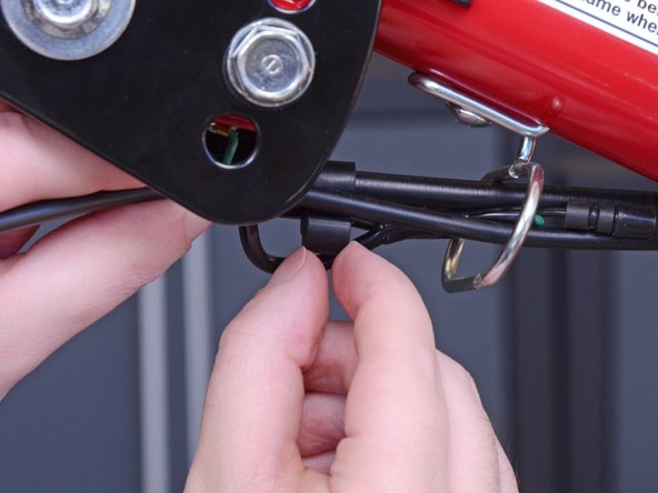

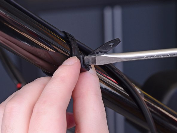

  17. Honda FC600 Tiller Throttle Cable Replacement, Throttle Cable: crwdns2935265:017crwdnd2935265:01crwdnd2935265:03crwdne2935265:0 Honda FC600 Tiller Throttle Cable Replacement, Throttle Cable: crwdns2935265:017crwdnd2935265:02crwdnd2935265:03crwdne2935265:0 Honda FC600 Tiller Throttle Cable Replacement, Throttle Cable: crwdns2935265:017crwdnd2935265:03crwdnd2935265:03crwdne2935265:0
    • Insert a flathead screwdriver in between the release tab and the tip of the cable tie securing the throttle cable to the handlebar.
    • Twist the screwdriver to separate the release tab and loosen the cable tie.
    • Repeat this step for the remaining cable ties.

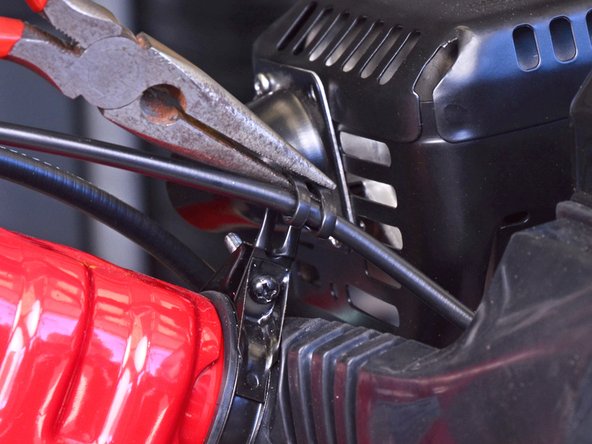

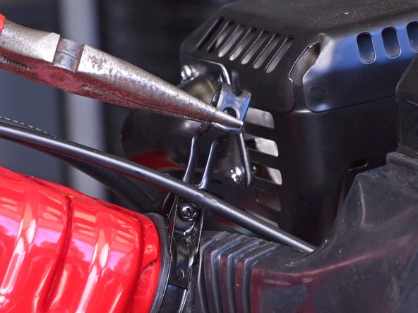

  19. Honda FC600 Tiller Throttle Cable Replacement: crwdns2935265:019crwdnd2935265:01crwdnd2935265:03crwdne2935265:0 Honda FC600 Tiller Throttle Cable Replacement: crwdns2935265:019crwdnd2935265:02crwdnd2935265:03crwdne2935265:0 Honda FC600 Tiller Throttle Cable Replacement: crwdns2935265:019crwdnd2935265:03crwdnd2935265:03crwdne2935265:0

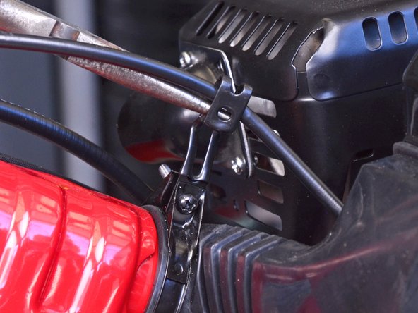

    • Use a pair of needle nose pliers to bend the metal clip at the bottom of the handle column out and upward.
  20. Honda FC600 Tiller Throttle Cable Replacement: crwdns2935265:020crwdnd2935265:01crwdnd2935265:02crwdne2935265:0 Honda FC600 Tiller Throttle Cable Replacement: crwdns2935265:020crwdnd2935265:02crwdnd2935265:02crwdne2935265:0
    • Use a pair of needle nose pliers to bend the last section of the metal clip outward to release the throttle cable.

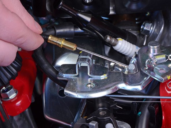

  21. Honda FC600 Tiller Throttle Cable Replacement: crwdns2935265:021crwdnd2935265:01crwdnd2935265:03crwdne2935265:0 Honda FC600 Tiller Throttle Cable Replacement: crwdns2935265:021crwdnd2935265:02crwdnd2935265:03crwdne2935265:0 Honda FC600 Tiller Throttle Cable Replacement: crwdns2935265:021crwdnd2935265:03crwdnd2935265:03crwdne2935265:0
    • Grab the end of the throttle cable with your fingers and push the cable inwards so that it lines up with the small cutout on the control lever.
    • Lift the throttle cable straight up to free it from the control lever.

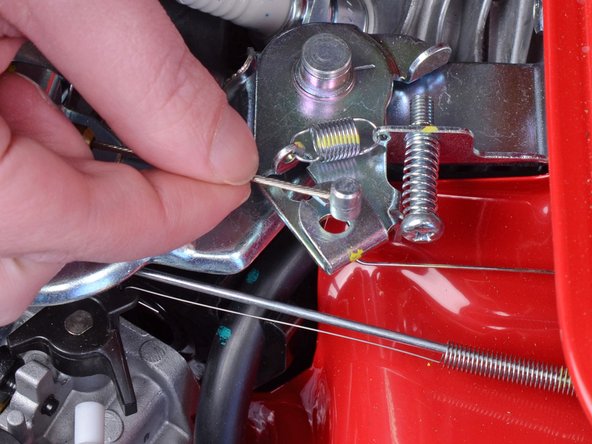

  22. Honda FC600 Tiller Throttle Cable Replacement: crwdns2935265:022crwdnd2935265:01crwdnd2935265:03crwdne2935265:0 Honda FC600 Tiller Throttle Cable Replacement: crwdns2935265:022crwdnd2935265:02crwdnd2935265:03crwdne2935265:0 Honda FC600 Tiller Throttle Cable Replacement: crwdns2935265:022crwdnd2935265:03crwdnd2935265:03crwdne2935265:0
    • Grab onto the end of the throttle cable housing and pull it out of its holder on the control lever.
    • Lift the throttle cable straight up to completely remove it from the control lever.
