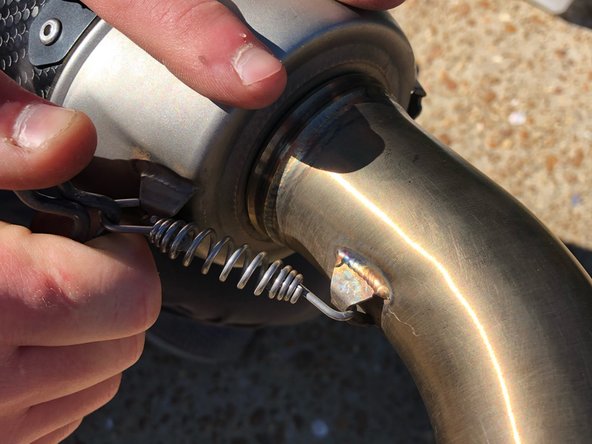

  3. Honda CRF250L Exhaust Replacement: crwdns2935265:03crwdnd2935265:01crwdnd2935265:02crwdne2935265:0 Honda CRF250L Exhaust Replacement: crwdns2935265:03crwdnd2935265:02crwdnd2935265:02crwdne2935265:0
    • Hook the spring on to one of the slots that is welded on the pipe and exhaust.
    • Then, expand the spring to hook around the opposing slot using the spring hook.

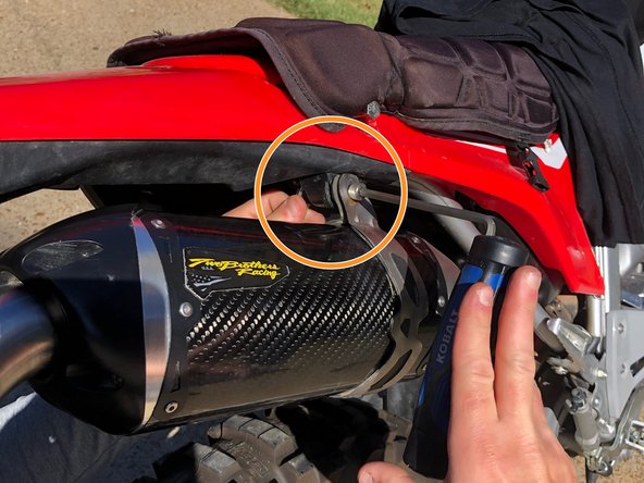

  5. Honda CRF250L Exhaust Replacement: crwdns2935265:05crwdnd2935265:01crwdnd2935265:01crwdne2935265:0
    • Slide the mount over the exhaust.
  6. Honda CRF250L Exhaust Replacement: crwdns2935265:06crwdnd2935265:01crwdnd2935265:01crwdne2935265:0
    • Slide the new exhaust onto the header.
    • The exhaust should curve upward.

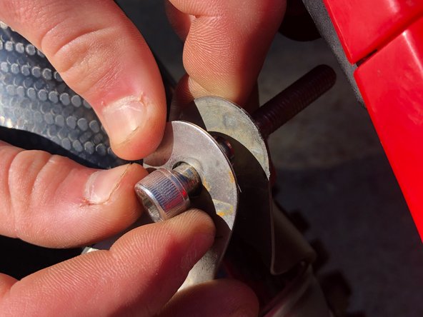

  7. Honda CRF250L Exhaust Replacement: crwdns2935265:07crwdnd2935265:01crwdnd2935265:02crwdne2935265:0 Honda CRF250L Exhaust Replacement: crwdns2935265:07crwdnd2935265:02crwdnd2935265:02crwdne2935265:0
    • Make sure that the mount is positioned to allow all holes to line up.
    • Insert the internal hex socket bolt.

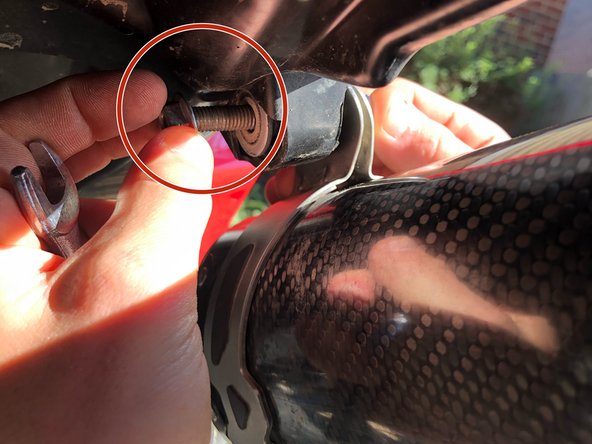

  8. Honda CRF250L Exhaust Replacement: crwdns2935265:08crwdnd2935265:01crwdnd2935265:03crwdne2935265:0 Honda CRF250L Exhaust Replacement: crwdns2935265:08crwdnd2935265:02crwdnd2935265:03crwdne2935265:0 Honda CRF250L Exhaust Replacement: crwdns2935265:08crwdnd2935265:03crwdnd2935265:03crwdne2935265:0
    • Insert the bolt attached to the mount.
    • Install the nut to the backside of the internal hex socket bolt.
    • Tighten the internal hex socket bolt using the 6mm Allen wrench.
    • Keep the nut stationary using the 1/2" open-ended wrench.
