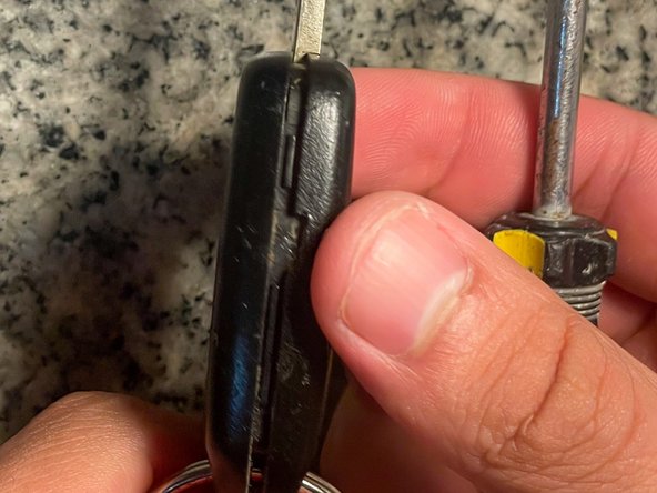

    • Each key should have a small gap. Locate this gap on the side of your key.
    • After you have taken off the screw, place the small screw somewhere safe. Then with the same screwdriver or a flathead screwdriver, you want to apply pressure to the small gap to pop it open.
  4. Honda Accord Car Key Remote: crwdns2935265:04crwdnd2935265:01crwdnd2935265:03crwdne2935265:0 Honda Accord Car Key Remote: crwdns2935265:04crwdnd2935265:02crwdnd2935265:03crwdne2935265:0 Honda Accord Car Key Remote: crwdns2935265:04crwdnd2935265:03crwdnd2935265:03crwdne2935265:0
    • This is an example of how the key should look after you pop it open.

You listed the wrong battery. It uses a CR1620 not a CR2032. Your picture even shows the correct battery. Also I believe it is a P000 screwdriver, that is what fit my 2013 Accord key.
