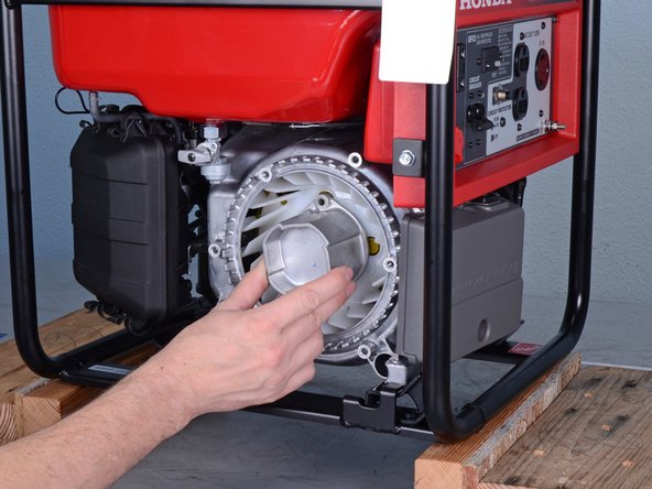

  1. Honda 3000 Watt Generator EB3000CK2A Recoil Starter Assembly Replacement, Disconnect the spark plug: crwdns2935265:01crwdnd2935265:01crwdnd2935265:02crwdne2935265:0 Honda 3000 Watt Generator EB3000CK2A Recoil Starter Assembly Replacement, Disconnect the spark plug: crwdns2935265:01crwdnd2935265:02crwdnd2935265:02crwdne2935265:0
    • Before you begin, disconnect the spark plug connector from the spark plug.
  2. Honda 3000 Watt Generator EB3000CK2A Recoil Starter Assembly Replacement, Remove the recoil starter assembly: crwdns2935265:02crwdnd2935265:01crwdnd2935265:03crwdne2935265:0 Honda 3000 Watt Generator EB3000CK2A Recoil Starter Assembly Replacement, Remove the recoil starter assembly: crwdns2935265:02crwdnd2935265:02crwdnd2935265:03crwdne2935265:0 Honda 3000 Watt Generator EB3000CK2A Recoil Starter Assembly Replacement, Remove the recoil starter assembly: crwdns2935265:02crwdnd2935265:03crwdnd2935265:03crwdne2935265:0
    • Use a 10 mm socket to remove the three 12 mm-long bolts securing the recoil starter assembly.
    • Remove the recoil starter assembly.
  3. Honda 3000 Watt Generator EB3000CK2A Recoil Starter Assembly Replacement, Remove the recoil starter pulley: crwdns2935265:03crwdnd2935265:01crwdnd2935265:03crwdne2935265:0 Honda 3000 Watt Generator EB3000CK2A Recoil Starter Assembly Replacement, Remove the recoil starter pulley: crwdns2935265:03crwdnd2935265:02crwdnd2935265:03crwdne2935265:0 Honda 3000 Watt Generator EB3000CK2A Recoil Starter Assembly Replacement, Remove the recoil starter pulley: crwdns2935265:03crwdnd2935265:03crwdnd2935265:03crwdne2935265:0
    • Use a 10 mm socket to remove the two 20 mm-long bolts securing the recoil starter pulley.
    • Remove the recoil starter pulley.
