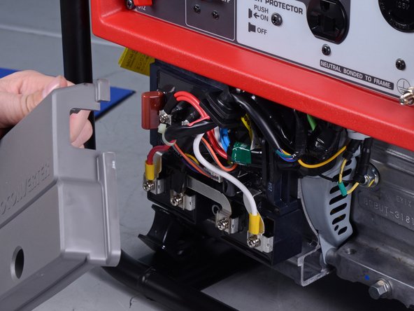

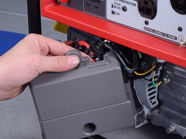

  2. Honda 3000 Watt Generator EB3000CK2A Cyclo Converter Replacement, Unfasten the cyclo converter cover: crwdns2935265:02crwdnd2935265:01crwdnd2935265:01crwdne2935265:0
    • Use a 10 mm socket to remove the nut securing the top of the cyclo converter cover.
    • Use a 10 mm socket to remove the bolt securing the bottom of the cyclo converter cover.
  3. Honda 3000 Watt Generator EB3000CK2A Cyclo Converter Replacement: crwdns2935265:03crwdnd2935265:01crwdnd2935265:03crwdne2935265:0 Honda 3000 Watt Generator EB3000CK2A Cyclo Converter Replacement: crwdns2935265:03crwdnd2935265:02crwdnd2935265:03crwdne2935265:0 Honda 3000 Watt Generator EB3000CK2A Cyclo Converter Replacement: crwdns2935265:03crwdnd2935265:03crwdnd2935265:03crwdne2935265:0
    • Un-slot the two black rubber cable grommets from the top and right edge of the plastic cover.
    • Remove the cyclo converter cover.

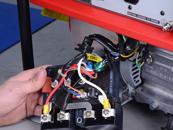

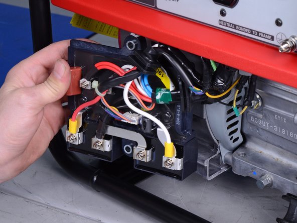

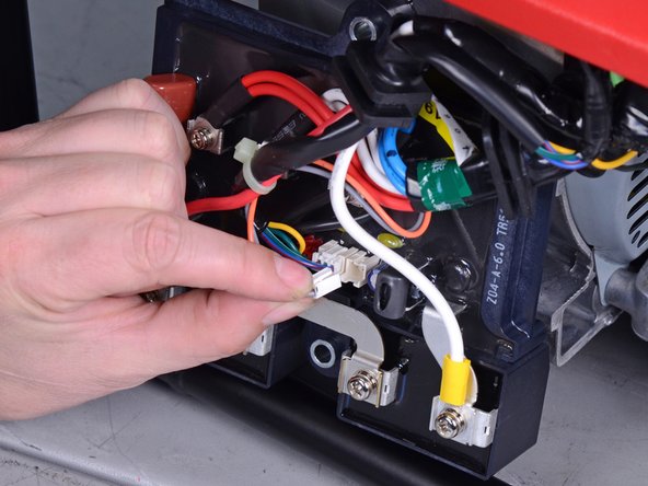

  4. Honda 3000 Watt Generator EB3000CK2A Cyclo Converter Replacement, Disconnect the cyclo converter: crwdns2935265:04crwdnd2935265:01crwdnd2935265:03crwdne2935265:0 Honda 3000 Watt Generator EB3000CK2A Cyclo Converter Replacement, Disconnect the cyclo converter: crwdns2935265:04crwdnd2935265:02crwdnd2935265:03crwdne2935265:0 Honda 3000 Watt Generator EB3000CK2A Cyclo Converter Replacement, Disconnect the cyclo converter: crwdns2935265:04crwdnd2935265:03crwdnd2935265:03crwdne2935265:0
    • Pull the cyclo converter panel off of its posts on the generator body so the screw terminals are easily accessible.

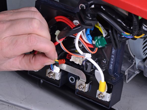

  5. Honda 3000 Watt Generator EB3000CK2A Cyclo Converter Replacement: crwdns2935265:05crwdnd2935265:01crwdnd2935265:03crwdne2935265:0 Honda 3000 Watt Generator EB3000CK2A Cyclo Converter Replacement: crwdns2935265:05crwdnd2935265:02crwdnd2935265:03crwdne2935265:0 Honda 3000 Watt Generator EB3000CK2A Cyclo Converter Replacement: crwdns2935265:05crwdnd2935265:03crwdnd2935265:03crwdne2935265:0
    • Disconnect the two 2-pin and one 3-pin connectors from the panel.
    • Take note of which connector corresponds with each header for reassembly.
    • Reassembly tip: The connectors are keyed so they can not be plugged in with the wrong orientation.

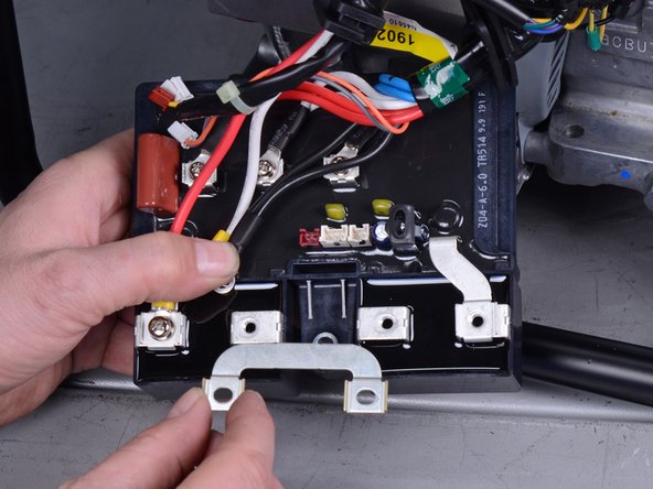

  6. Honda 3000 Watt Generator EB3000CK2A Cyclo Converter Replacement, Disassembly tip: crwdns2935265:06crwdnd2935265:01crwdnd2935265:01crwdne2935265:0
    • If you are replacing the cyclo converter panel, it can be helpful to transfer a cable from the old panel to the corresponding screw terminal on the replacement panel one at a time. This prevents potentially mixing up cables and screws and maintains OEM cable management.
    • The top three screws are M4 screws while the bottom four are M5 screws. Ensure you are using the correct screw for each terminal during reassembly.
  7. Honda 3000 Watt Generator EB3000CK2A Cyclo Converter Replacement: crwdns2935265:07crwdnd2935265:01crwdnd2935265:01crwdne2935265:0
    • Use a Phillips #2 screwdriver to remove the seven 10 mm screws from the terminals on the cyclo converter panel. The wire that corresponds with each terminal is listed below:
    • Red cable
    • Double Black cable
    • No cable
    • White Cable
    • Double Red cable
    • Double White cable
    • Double Blue cable
  8. Honda 3000 Watt Generator EB3000CK2A Cyclo Converter Replacement: crwdns2935265:08crwdnd2935265:01crwdnd2935265:02crwdne2935265:0 Honda 3000 Watt Generator EB3000CK2A Cyclo Converter Replacement: crwdns2935265:08crwdnd2935265:02crwdnd2935265:02crwdne2935265:0
    • Remove the terminal connecting bar from the panel once the corresponding terminals are unscrewed.
    • During reassembly, ensure the bar is in the correct orientation and lies under the crimp connector on the double black cable.
