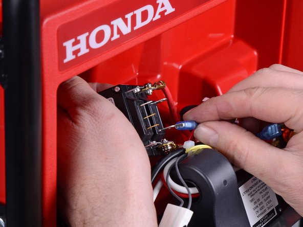

    • Disconnect the two spade crimp connectors from the breaker.
    • This may require a significant amount of force. If you are having trouble, you can use pliers to grip the connectors. Pull only on the blue crimp connector, not the actual wire.
  9. Honda 3000 Watt Generator EB3000CK2A Circuit Breaker Replacement: crwdns2935265:09crwdnd2935265:01crwdnd2935265:02crwdne2935265:0 Honda 3000 Watt Generator EB3000CK2A Circuit Breaker Replacement: crwdns2935265:09crwdnd2935265:02crwdnd2935265:02crwdne2935265:0
    • Use a Phillips #2 screwdriver to remove the two 6 mm screws securing the cables to the terminals on the breaker.
