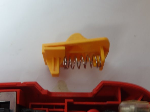

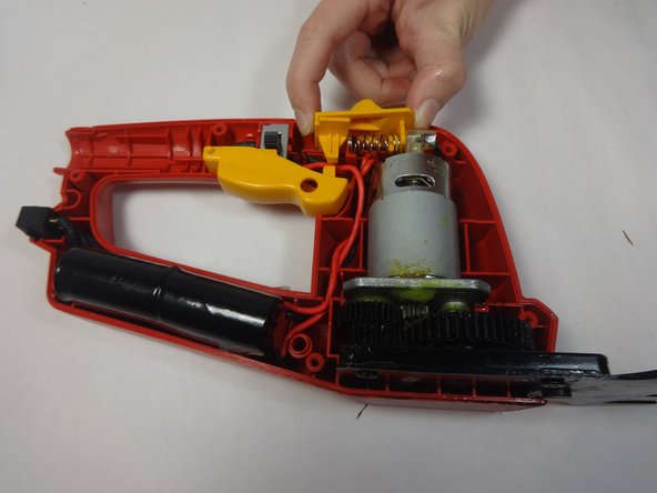

    3. Homelite UT44172 Safety Switch Replacement, Switch Removal: crwdns2935265:03crwdnd2935265:01crwdnd2935265:03crwdne2935265:0 Homelite UT44172 Safety Switch Replacement, Switch Removal: crwdns2935265:03crwdnd2935265:02crwdnd2935265:03crwdne2935265:0 Homelite UT44172 Safety Switch Replacement, Switch Removal: crwdns2935265:03crwdnd2935265:03crwdnd2935265:03crwdne2935265:0
      • Remove the safety switch by pulling it away from the body of device.
      • Be careful not to lose the spring, which is under pressure and may fly out during removal.
    4. Homelite UT44172 Safety Switch Replacement, Spring Replacement: crwdns2935265:04crwdnd2935265:01crwdnd2935265:01crwdne2935265:0
      • Inspect both the spring and the switch to see if either is deformed or damaged. If so, replace the damaged part with a new part.
      • During reassembly, gently move the inner wires out of the way so they do not get caught in the spring.
