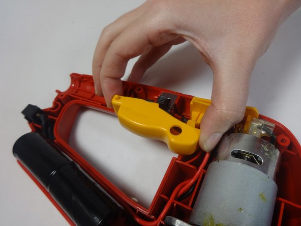

  3. Homelite UT44172 Operating Switch Replacement, Switch Removal: crwdns2935265:03crwdnd2935265:01crwdnd2935265:02crwdne2935265:0 Homelite UT44172 Operating Switch Replacement, Switch Removal: crwdns2935265:03crwdnd2935265:02crwdnd2935265:02crwdne2935265:0
    • Locate and remove the operating switch from the device.
  4. Homelite UT44172 Operating Switch Replacement, Spring Replacement: crwdns2935265:04crwdnd2935265:01crwdnd2935265:01crwdne2935265:0
    • Replace the spring if it is deformed or broken.
    • Be careful that the wires do not get caught in the spring when replacing it.
