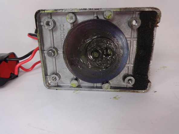

    2. Homelite UT44172 Blades Replacement, Removing Faceplate: crwdns2935265:02crwdnd2935265:01crwdnd2935265:01crwdne2935265:0
      • Remove the face plate by lifting it away from the other half of the device. This will expose the interior.

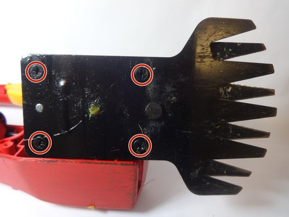

    3. Homelite UT44172 Blades Replacement, Exposing Blade Components: crwdns2935265:03crwdnd2935265:01crwdnd2935265:02crwdne2935265:0 Homelite UT44172 Blades Replacement, Exposing Blade Components: crwdns2935265:03crwdnd2935265:02crwdnd2935265:02crwdne2935265:0
      • Use the Phillips #2 screwdriver to remove the four 10.0 mm screws on the bottom of the blades.

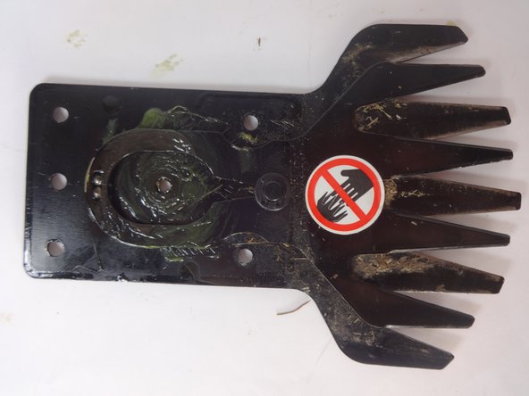

    4. Homelite UT44172 Blades Replacement, Replacing Blades: crwdns2935265:04crwdnd2935265:01crwdnd2935265:03crwdne2935265:0 Homelite UT44172 Blades Replacement, Replacing Blades: crwdns2935265:04crwdnd2935265:02crwdnd2935265:03crwdne2935265:0 Homelite UT44172 Blades Replacement, Replacing Blades: crwdns2935265:04crwdnd2935265:03crwdnd2935265:03crwdne2935265:0
      • Remove the old blades by pulling them away from the gears and motor.
      • Be careful handling the blades. They are sharp.
