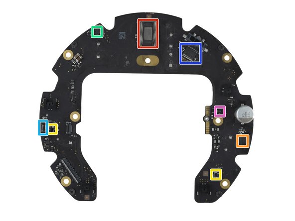

    7. HomePod 2 Chip ID, Audio Board Side 1: crwdns2935265:07crwdnd2935265:01crwdnd2935265:02crwdne2935265:0 HomePod 2 Chip ID, Audio Board Side 1: crwdns2935265:07crwdnd2935265:02crwdnd2935265:02crwdne2935265:0
      • Analog Devices SSM3515B audio amplifier
      • Texas Instruments PCM5242 stereo D/A converter
      • MEMS Microphones
      • Texas Instruments TLV320ADC3100 stereo A/D converter
      • Analog Devices ADAU7002 stereo PDM–to-I2S or TDM converter
      • Texas Instruments TPS54560B 5 A step-down DC-DC converter
      • Texas Instruments INA210A ? current sense amplifier

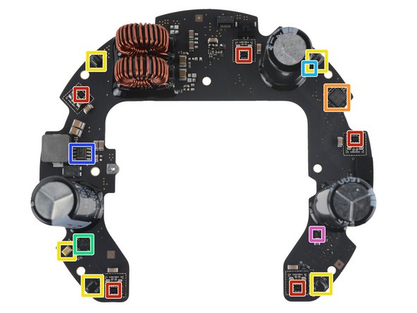

    9. HomePod 2 Chip ID, Audio Board Side 2: crwdns2935265:09crwdnd2935265:01crwdnd2935265:02crwdne2935265:0 HomePod 2 Chip ID, Audio Board Side 2: crwdns2935265:09crwdnd2935265:02crwdnd2935265:02crwdne2935265:0
      • Texas Instruments TPA3255C audio amplifier
      • Texas Instruments TLV320ADC3100 stereo audio A/D converter
      • Texas Instruments TLA2528 8-Ch, 12-Bit A/D Converter
      • MEMS Microphone
      • Texas Instruments INA253A1 current sense amplifier

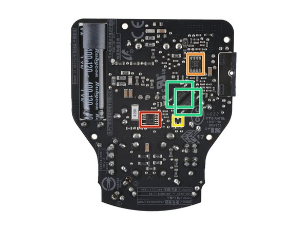

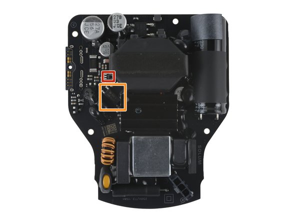

    12. HomePod 2 Chip ID, Power Supply Board Side 1: crwdns2935265:012crwdnd2935265:01crwdnd2935265:02crwdne2935265:0 HomePod 2 Chip ID, Power Supply Board Side 1: crwdns2935265:012crwdnd2935265:02crwdnd2935265:02crwdne2935265:0
    13. HomePod 2 Chip ID, Power Supply Board Side 2: crwdns2935265:013crwdnd2935265:01crwdnd2935265:02crwdne2935265:0 HomePod 2 Chip ID, Power Supply Board Side 2: crwdns2935265:013crwdnd2935265:02crwdnd2935265:02crwdne2935265:0
