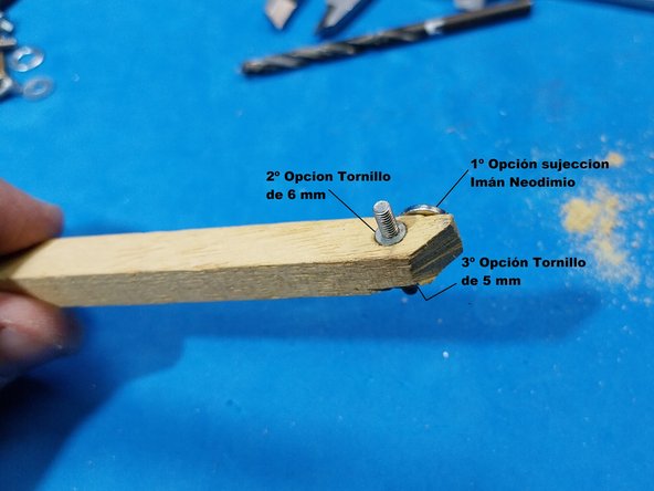

    • Homemade construction tool, for holding screws using 3 options, Neodymium Magnet, left side slot for 6 mm head screw and right side slot for 5 mm head screw.

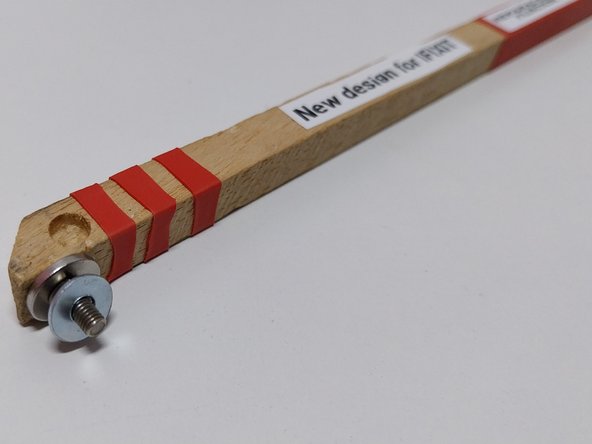

    • To fix the Neodymium magnet to the wooden strip, just 1 drop of instant-drying glue, cyanoacrylate type.
    • If we put a screw in the magnet, it can be handled and positioned in the wooden strip more easily.
  4. Home construction tool fixing screws toaster repair (Model #1): crwdns2935265:04crwdnd2935265:01crwdnd2935265:03crwdne2935265:0 Home construction tool fixing screws toaster repair (Model #1): crwdns2935265:04crwdnd2935265:02crwdnd2935265:03crwdne2935265:0 Home construction tool fixing screws toaster repair (Model #1): crwdns2935265:04crwdnd2935265:03crwdnd2935265:03crwdne2935265:0
    • Views of the Neodymium magnet fixed to the wooden strip.

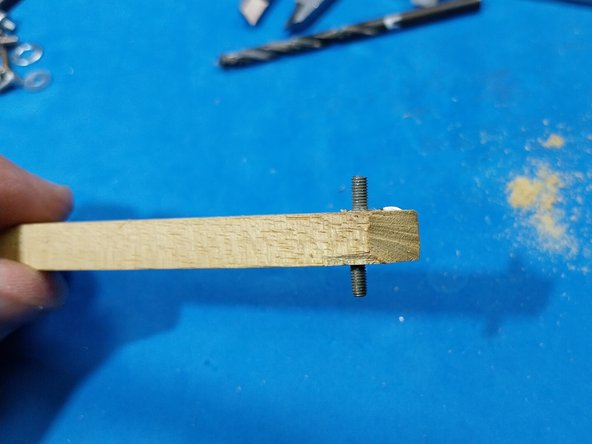

    • On the 2 sides of the wooden strip, next to the magnet, I have made 2 small holes, (Depth 3 to 4 mm) of 5 mm and 6 mm on the other side, to be able to insert "fixing" two separate 5 mm head screws and 6mm.
  6. Home construction tool fixing screws toaster repair (Model #1): crwdns2935265:06crwdnd2935265:01crwdnd2935265:03crwdne2935265:0 Home construction tool fixing screws toaster repair (Model #1): crwdns2935265:06crwdnd2935265:02crwdnd2935265:03crwdne2935265:0 Home construction tool fixing screws toaster repair (Model #1): crwdns2935265:06crwdnd2935265:03crwdnd2935265:03crwdne2935265:0
    • View of the 6 mm and 5 mm screws in the test positioning in the batten.
  7. Home construction tool fixing screws toaster repair (Model #1): crwdns2935265:07crwdnd2935265:01crwdnd2935265:02crwdne2935265:0 Home construction tool fixing screws toaster repair (Model #1): crwdns2935265:07crwdnd2935265:02crwdnd2935265:02crwdne2935265:0
    • Views of one of the 4mm deep holes

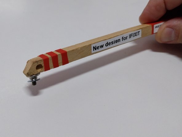

  8. Home construction tool fixing screws toaster repair (Model #1): crwdns2935265:08crwdnd2935265:01crwdnd2935265:03crwdne2935265:0 Home construction tool fixing screws toaster repair (Model #1): crwdns2935265:08crwdnd2935265:02crwdnd2935265:03crwdne2935265:0 Home construction tool fixing screws toaster repair (Model #1): crwdns2935265:08crwdnd2935265:03crwdnd2935265:03crwdne2935265:0
    • This step is merely decorative, it is made with a red shrink tube to give it a decorative end and to make it easier to see when it is inserted into the toaster.
    • The heat shrink tubing shrinks and adapts to the surface where it is placed by applying hot air.

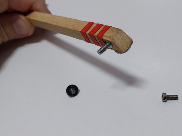

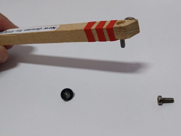

    • Views of the finished homemade tool, this is a new design of the original tool that I used, this new design is specially dedicated to the friends of IFIXIT, in another I will document the 2nd Tool that I have made, more elaborate. And I will show the 3 options.
  11. Home construction tool fixing screws toaster repair (Model #1): crwdns2935265:011crwdnd2935265:01crwdnd2935265:03crwdne2935265:0 Home construction tool fixing screws toaster repair (Model #1): crwdns2935265:011crwdnd2935265:02crwdnd2935265:03crwdne2935265:0 Home construction tool fixing screws toaster repair (Model #1): crwdns2935265:011crwdnd2935265:03crwdnd2935265:03crwdne2935265:0
    • Views of the finished tool, in detail.
