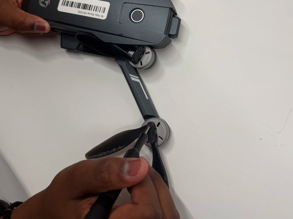

    • Lay out the drone so that its arms are out and oriented upwards.
    • This will allow to access all the propellers.
  2. Holy Stone HS720E Propeller Replacement: crwdns2935265:02crwdnd2935265:01crwdnd2935265:03crwdne2935265:0 Holy Stone HS720E Propeller Replacement: crwdns2935265:02crwdnd2935265:02crwdnd2935265:03crwdne2935265:0 Holy Stone HS720E Propeller Replacement: crwdns2935265:02crwdnd2935265:03crwdnd2935265:03crwdne2935265:0
    • Remove the two 1 mm screws securing the propeller using a Phillips #00 screwdriver.
    • Some pressure will be needed when unscrewing or it won't be easy due to the swivel mount.
    • Remove the damaged/malfunctioning propeller.

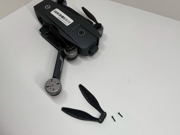

  3. Holy Stone HS720E Propeller Replacement: crwdns2935265:03crwdnd2935265:01crwdnd2935265:01crwdne2935265:0
    • While the swivel mount is exposed, remove any debris found. Removing the debris will improve the drone's performance.
    • When fastening the replacement propeller, be sure that the screws are inserted into the two holes on the swivel mount.
