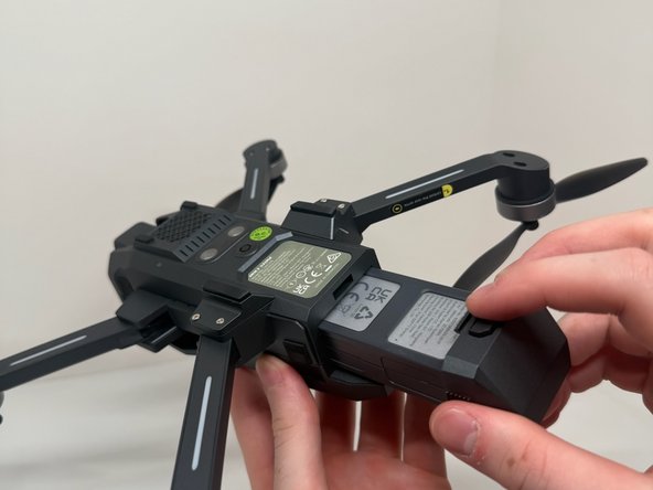

    • Flip the drone upside down.
  2. Holy Stone HS720E Camera Replacement: crwdns2935265:02crwdnd2935265:01crwdnd2935265:02crwdne2935265:0 Holy Stone HS720E Camera Replacement: crwdns2935265:02crwdnd2935265:02crwdnd2935265:02crwdne2935265:0
    • Press and hold the button on top of the battery.
  3. Holy Stone HS720E Camera Replacement: crwdns2935265:03crwdnd2935265:01crwdnd2935265:02crwdne2935265:0 Holy Stone HS720E Camera Replacement: crwdns2935265:03crwdnd2935265:02crwdnd2935265:02crwdne2935265:0
    • While still holding the button down, slide the battery out towards yourself.

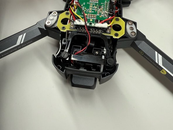

  7. Holy Stone HS720E Camera Replacement: crwdns2935265:07crwdnd2935265:01crwdnd2935265:02crwdne2935265:0 Holy Stone HS720E Camera Replacement: crwdns2935265:07crwdnd2935265:02crwdnd2935265:02crwdne2935265:0
    • Remove the screws from the lower body of the drone using a Phillips #1 screwdriver.

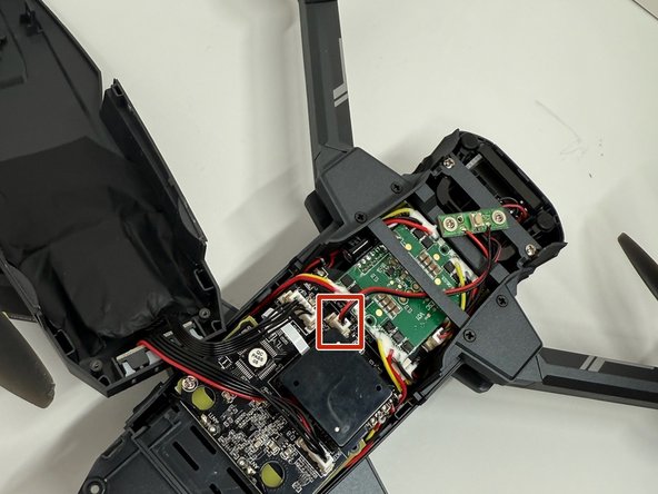

  8. Holy Stone HS720E Camera Replacement: crwdns2935265:08crwdnd2935265:01crwdnd2935265:02crwdne2935265:0 Holy Stone HS720E Camera Replacement: crwdns2935265:08crwdnd2935265:02crwdnd2935265:02crwdne2935265:0
    • Unplug the wire connected to the motherboard and remove the camera.
