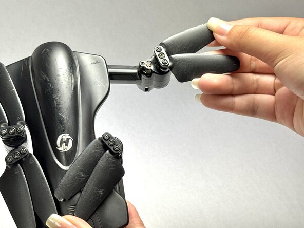

  2. Holy Stone HS165 Drone Arm Gear Replacement: crwdns2935265:02crwdnd2935265:01crwdnd2935265:02crwdne2935265:0 Holy Stone HS165 Drone Arm Gear Replacement: crwdns2935265:02crwdnd2935265:02crwdnd2935265:02crwdne2935265:0
    • Remove the three 1.5 mm screws holding the propellers in place.
    • Pull out the propeller.
    • This can be done once you've removed the top of the drone which you'll be able to do once you've removed the screws.

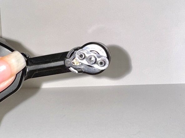

  3. Holy Stone HS165 Drone Arm Gear Replacement: crwdns2935265:03crwdnd2935265:01crwdnd2935265:01crwdne2935265:0
    • Remove the small plastic cap that's under the propellers.

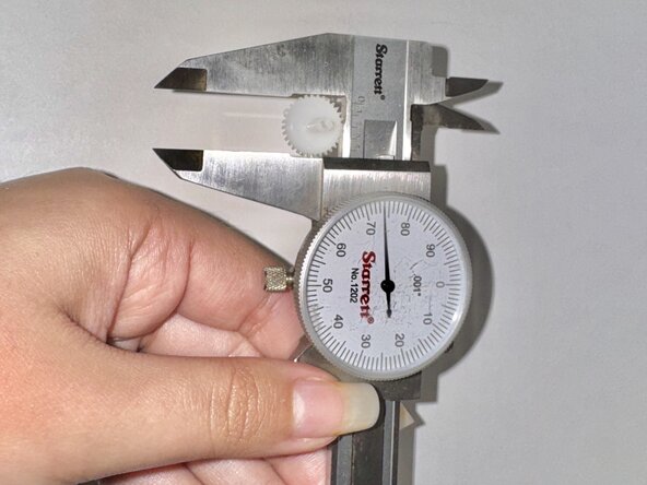

    • Using a caliper, measure the size of the gear.
  7. Holy Stone HS165 Drone Arm Gear Replacement: crwdns2935265:07crwdnd2935265:01crwdnd2935265:01crwdne2935265:0
    • Pull out the bag of plastic gears and find one that matches the original size.
    • To measure the size of the gears accurately, use your caliper again.
