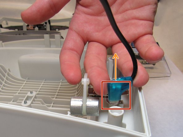

  5. Holmes HEH8031 Safety Weight Replacement, Safety Weight: crwdns2935265:05crwdnd2935265:01crwdnd2935265:02crwdne2935265:0 Holmes HEH8031 Safety Weight Replacement, Safety Weight: crwdns2935265:05crwdnd2935265:02crwdnd2935265:02crwdne2935265:0
    • Remove wires from safety weight, as shown.
    • Pull upward on the blue connectors.
    • If connectors are tough to remove, try wiggling while pulling upward.
  6. Holmes HEH8031 Safety Weight Replacement: crwdns2935265:06crwdnd2935265:01crwdnd2935265:01crwdne2935265:0
    • Unscrew the Phillips #2 10 mm screw from the safety weight on the rear housing panel.
