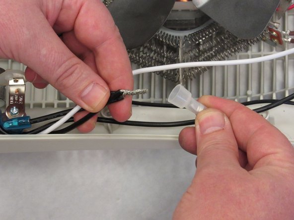

  4. Holmes HEH8031 Power Cord Replacement, Power Cord: crwdns2935265:04crwdnd2935265:01crwdnd2935265:03crwdne2935265:0 Holmes HEH8031 Power Cord Replacement, Power Cord: crwdns2935265:04crwdnd2935265:02crwdnd2935265:03crwdne2935265:0 Holmes HEH8031 Power Cord Replacement, Power Cord: crwdns2935265:04crwdnd2935265:03crwdnd2935265:03crwdne2935265:0
    • Decrimp the wire nuts from both wire connections.
    • Remove wire nuts to expose wire strands.
    • Separate all connected wires.

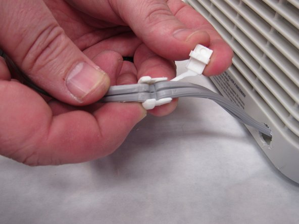

  5. Holmes HEH8031 Power Cord Replacement: crwdns2935265:05crwdnd2935265:01crwdnd2935265:03crwdne2935265:0 Holmes HEH8031 Power Cord Replacement: crwdns2935265:05crwdnd2935265:02crwdnd2935265:03crwdne2935265:0 Holmes HEH8031 Power Cord Replacement: crwdns2935265:05crwdnd2935265:03crwdnd2935265:03crwdne2935265:0

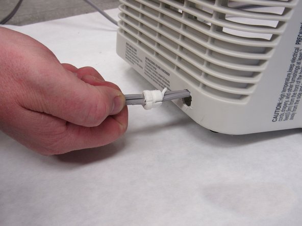

    • Pull on the cord from the outside of the heater with great finesse. At the same time, push the cord clamp out of the housing from the inside.
    • Separate the two halves of the cord clamp and remove from cord.

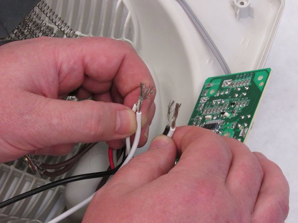

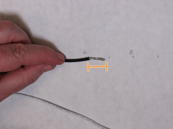

  6. Holmes HEH8031 Power Cord Replacement: crwdns2935265:06crwdnd2935265:01crwdnd2935265:02crwdne2935265:0 Holmes HEH8031 Power Cord Replacement: crwdns2935265:06crwdnd2935265:02crwdnd2935265:02crwdne2935265:0
    • Prepare the replacement cord by cutting the negative branch (black) at least 8 inches shorter than the positive branch (white).
    • Strip at least 3/4 inch of insulation from the cord to expose bare wire.
    • Twist wire ends to form a tight braid.
