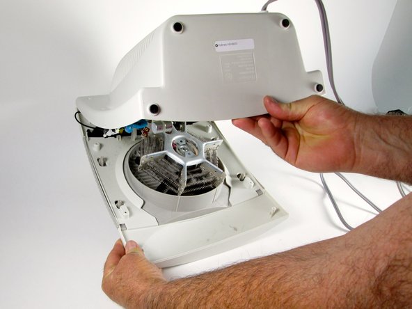

    • Place the heater so the rear housing is facing you.
    • Remove the eight (8) 1 cm coarse-threaded screws around the perimeter.
    • Remove the two (2) 7 mm machine screws in the center.
  3. Holmes HEH8031 Fan Blade Assembly Replacement: crwdns2935265:03crwdnd2935265:01crwdnd2935265:03crwdne2935265:0 Holmes HEH8031 Fan Blade Assembly Replacement: crwdns2935265:03crwdnd2935265:02crwdnd2935265:03crwdne2935265:0 Holmes HEH8031 Fan Blade Assembly Replacement: crwdns2935265:03crwdnd2935265:03crwdnd2935265:03crwdne2935265:0

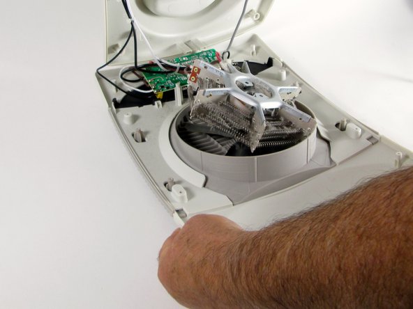

    • Using your fingers, pry bottom corner of housing open from bottom to top.
    • Wiring remains connected at the top of the front and rear of the housing. Don't pull too hard or you will disconnect the wires.

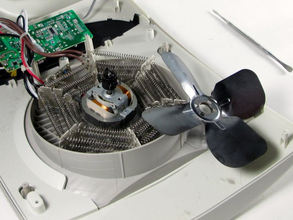

    • Fan and rotor assembly are not connected to the housing. They will be loose.

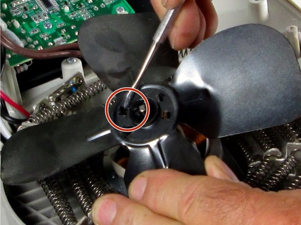

    • Turn the fan blade assembly over so blades are facing up.
    • Locate the four (4) metal tabs that connect the blade assembly to the rotor.

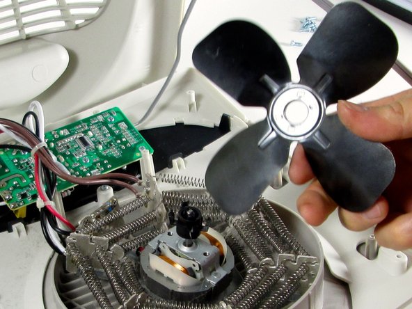

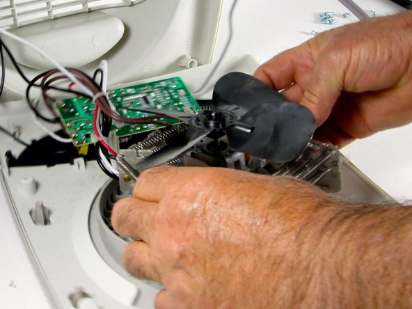

    • Lift the blade assembly off the rotor shaft.
    • You may need to wiggle the blade assembly slightly to free it from the rotor.
    • When reassembling the unit, you must replace the two (2) 7 mm machine screws that connect the rotor assembly to the housing before replacing the coarse-threaded screws. Aligning the 1 cm machine screws may take some finesse.
