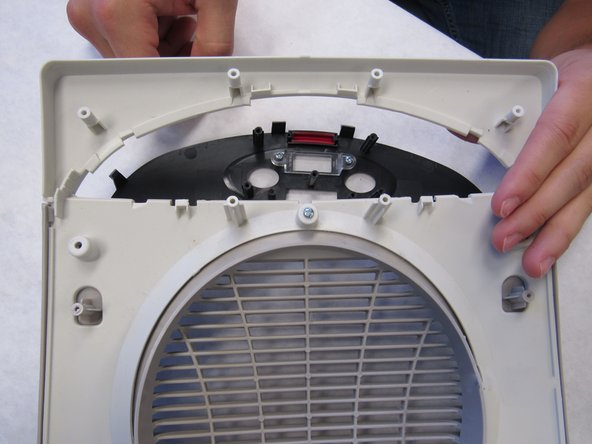

  3. Holmes HEH8031 Control Buttons Replacement: crwdns2935265:03crwdnd2935265:01crwdnd2935265:02crwdne2935265:0 Holmes HEH8031 Control Buttons Replacement: crwdns2935265:03crwdnd2935265:02crwdnd2935265:02crwdne2935265:0
    • Turn heater over so the controls are facing up.
    • Lift the front housing away from the back of the fan and slowly fold the front housing back down to the floor.
    • Internal wires are connected to both halves of the housing. Be careful when separating the housing.

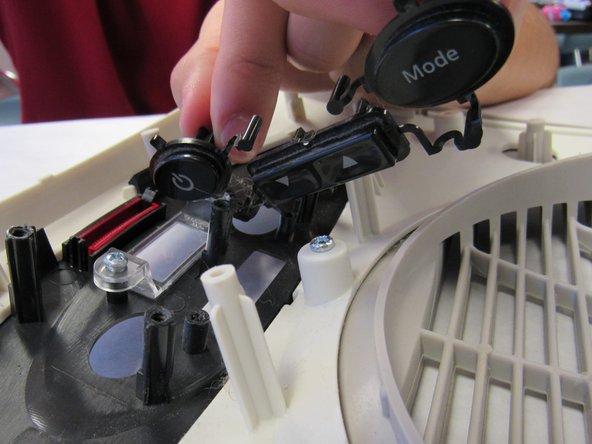

  5. Holmes HEH8031 Control Buttons Replacement, Control Buttons: crwdns2935265:05crwdnd2935265:01crwdnd2935265:03crwdne2935265:0 Holmes HEH8031 Control Buttons Replacement, Control Buttons: crwdns2935265:05crwdnd2935265:02crwdnd2935265:03crwdne2935265:0 Holmes HEH8031 Control Buttons Replacement, Control Buttons: crwdns2935265:05crwdnd2935265:03crwdnd2935265:03crwdne2935265:0
    • Remove the two Phillips #2 12mm screws from the button retainer.
    • Lift the button retainer off.
    • Remove the interconnected buttons.
    • If the buttons are broken, replace them.
    • If the buttons are sticking, clean them in warm soapy water and allow to dry.

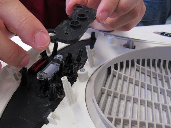

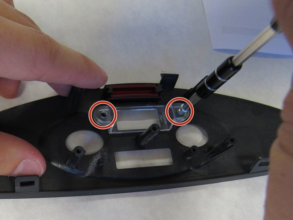

  6. Holmes HEH8031 Control Buttons Replacement: crwdns2935265:06crwdnd2935265:01crwdnd2935265:03crwdne2935265:0 Holmes HEH8031 Control Buttons Replacement: crwdns2935265:06crwdnd2935265:02crwdnd2935265:03crwdne2935265:0 Holmes HEH8031 Control Buttons Replacement: crwdns2935265:06crwdnd2935265:03crwdnd2935265:03crwdne2935265:0
    • Using light finger pressure, carefully push the black plastic tabs off the white plastic hooks.
    • Remove the black plastic bracket out through the front of the heater housing.
    • Remove the two Phillips #2 12mm screws and remove the clear window from the black plastic bracket.
    • If the buttons were sticking, clean the black plastic bracket in warm soapy water and allow to dry.
    • If the clear window was dirty, clean it in warm soapy water and allow to dry.
