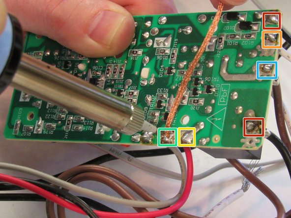

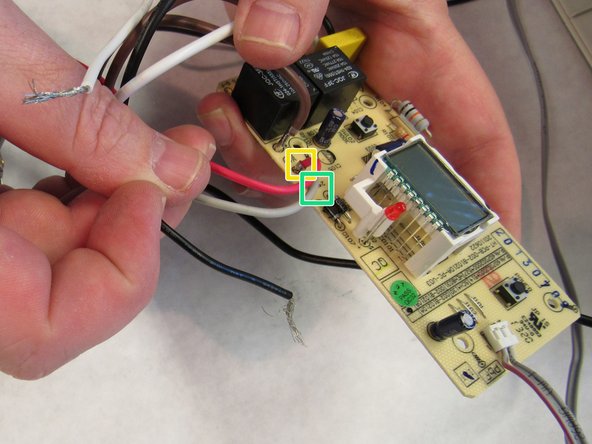

  4. Holmes HEH8031 Circuit Board Replacement, Circuit Board Removal: crwdns2935265:04crwdnd2935265:01crwdnd2935265:01crwdne2935265:0
    • Remove four 12mm Phillips #2 screws from the circuit board.
  5. Holmes HEH8031 Circuit Board Replacement, Circuit Board: crwdns2935265:05crwdnd2935265:01crwdnd2935265:03crwdne2935265:0 Holmes HEH8031 Circuit Board Replacement, Circuit Board: crwdns2935265:05crwdnd2935265:02crwdnd2935265:03crwdne2935265:0 Holmes HEH8031 Circuit Board Replacement, Circuit Board: crwdns2935265:05crwdnd2935265:03crwdnd2935265:03crwdne2935265:0
    • Desolder the BLACK wires from the "AC-L" point and "T/S" point.
    • Learn how to solder and desolder connections here!
    • Desolder the WHITE wire from the "AC-N" point.
    • Desolder the RED wire from the "FAN-RED".
    • Desolder the GREY wire from the "24V" point.
    • Desolder the BROWN wires from "HEAT1," and "HEAT2" points.
    • Be sure to use desoldering wick when you remove the wire connections.

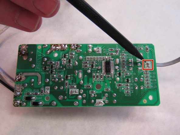

  6. Holmes HEH8031 Circuit Board Replacement: crwdns2935265:06crwdnd2935265:01crwdnd2935265:02crwdne2935265:0 Holmes HEH8031 Circuit Board Replacement: crwdns2935265:06crwdnd2935265:02crwdnd2935265:02crwdne2935265:0
    • Desolder the WHITE connector (attached to the GRAY wire coming of the thermostat) from the "NTC101" point.
