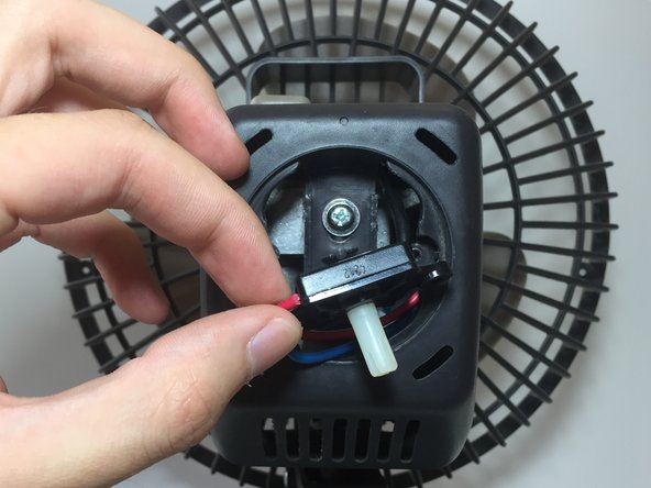

  6. Holmes Blizzard Fan Oscillation Button Replacement: crwdns2935265:06crwdnd2935265:01crwdnd2935265:02crwdne2935265:0 Holmes Blizzard Fan Oscillation Button Replacement: crwdns2935265:06crwdnd2935265:02crwdnd2935265:02crwdne2935265:0
    • The motor switch is also free and can be removed by hand to reveal a screw holding the housing assembly in place.
    • Be sure not to damage the wires on the switch during removal. While you do not need to be overly gentle during this step, excessive force could cause the wires to be pulled out.
  7. Holmes Blizzard Fan Oscillation Button Replacement: crwdns2935265:07crwdnd2935265:01crwdnd2935265:02crwdne2935265:0 Holmes Blizzard Fan Oscillation Button Replacement: crwdns2935265:07crwdnd2935265:02crwdnd2935265:02crwdne2935265:0
    • Remove the screw that holds the housing assembly in place by using a Phillips #2 Screwdriver.
