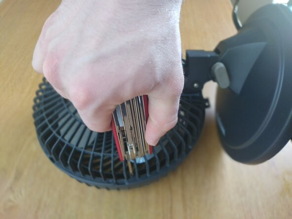

    • Unscrew the three black screws on the back of the fan head and place the screws aside.

    • Remove the fan grille and clean any dust from the blades.

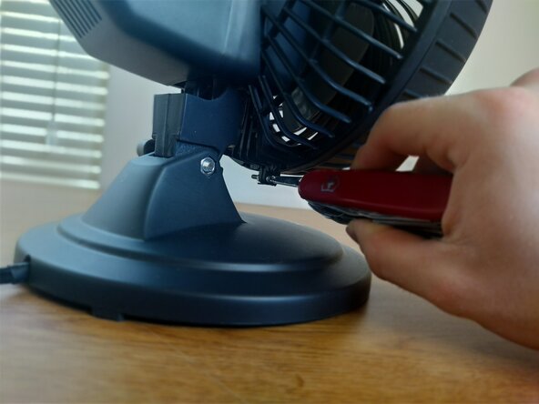

    • Unscrew the side of the fan above the knob and below the grille, then remove them.

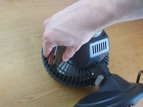

    • Remove the old knob and place the new adjustment knob into the base, then secure it in place.

    • Reattach the grille and secure the open parts of the fan.
    • Ensure the new knob is tight.
  6. Holmes Blizzard Electric Fan Adjustment Knob Replacement: crwdns2935265:06crwdnd2935265:01crwdnd2935265:02crwdne2935265:0 Holmes Blizzard Electric Fan Adjustment Knob Replacement: crwdns2935265:06crwdnd2935265:02crwdnd2935265:02crwdne2935265:0
    • Tighten the old and new screws back into place.
The cleaning procedure and knob replacement should help this fan operate with more stability while keeping things breezy. If it becomes difficult to remove screws or place them back, I recommend a pair of pliers just in case you run into any issues.
