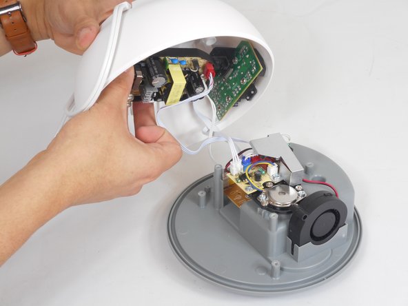

    • Remove the remaining four 7 mm screws that hold the bottom cover.
    • Remove the bottom cover.

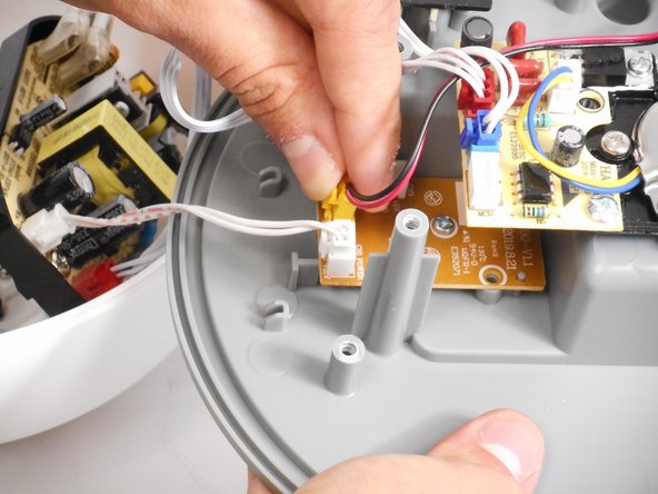

  5. HoMedics TotalComfort UHE-CM18 Fan Replacement: crwdns2935265:05crwdnd2935265:01crwdnd2935265:03crwdne2935265:0 HoMedics TotalComfort UHE-CM18 Fan Replacement: crwdns2935265:05crwdnd2935265:02crwdnd2935265:03crwdne2935265:0 HoMedics TotalComfort UHE-CM18 Fan Replacement: crwdns2935265:05crwdnd2935265:03crwdnd2935265:03crwdne2935265:0

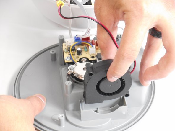

    • Disconnect the fan cable from the circuit board by pushing down the center at the end and pulling it out of its socket.
    • Remove the fan.
