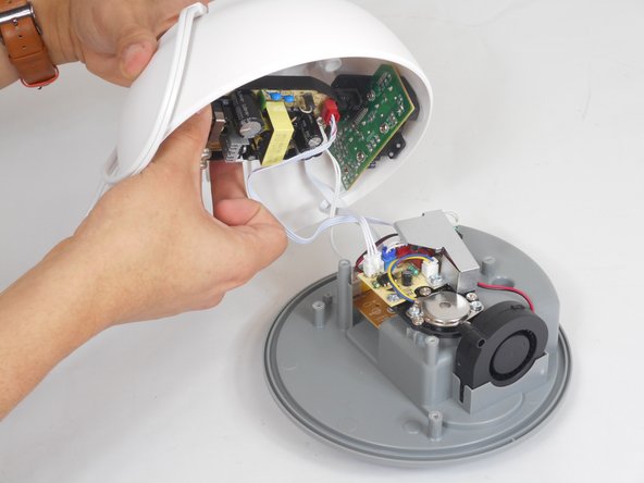

  4. HoMedics TotalComfort UHE-CM18 Control Panel Replacement: crwdns2935265:04crwdnd2935265:01crwdnd2935265:03crwdne2935265:0 HoMedics TotalComfort UHE-CM18 Control Panel Replacement: crwdns2935265:04crwdnd2935265:02crwdnd2935265:03crwdne2935265:0 HoMedics TotalComfort UHE-CM18 Control Panel Replacement: crwdns2935265:04crwdnd2935265:03crwdnd2935265:03crwdne2935265:0
    • Disconnect the two white cables by pushing down the center tab at the end and pulling it out of its socket.
