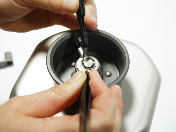

    • First, open up the home bakery and remove the bread pan.

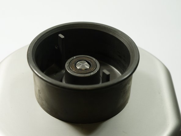

  2. Hitachi HB-B102 Automatic Home Bakery  II Seal Replacement: crwdns2935265:02crwdnd2935265:01crwdnd2935265:01crwdne2935265:0
    • Pull the paddle/mixer out from inside the bread pan.

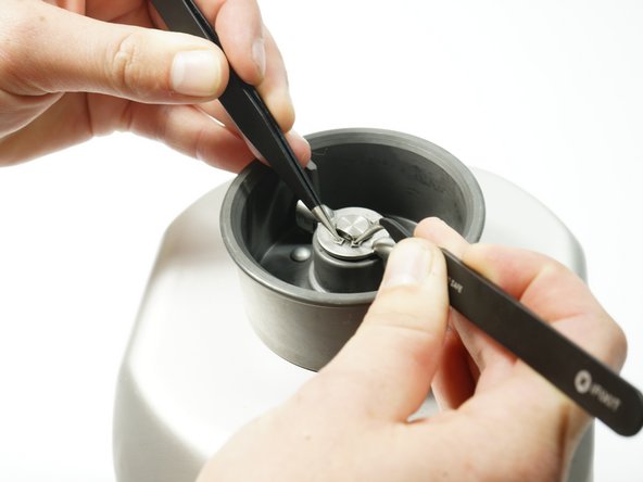

  3. Hitachi HB-B102 Automatic Home Bakery  II Seal Replacement: crwdns2935265:03crwdnd2935265:01crwdnd2935265:03crwdne2935265:0 Hitachi HB-B102 Automatic Home Bakery  II Seal Replacement: crwdns2935265:03crwdnd2935265:02crwdnd2935265:03crwdne2935265:0 Hitachi HB-B102 Automatic Home Bakery  II Seal Replacement: crwdns2935265:03crwdnd2935265:03crwdnd2935265:03crwdne2935265:0
    • Flip the bread pan over and locate the "C" shaped clip. Orient the clip so the ends line up with the flat part of the bolt. Using tweezers or "C" clip pliers, pry the clip apart and remove it.

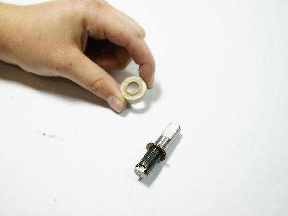

  4. Hitachi HB-B102 Automatic Home Bakery  II Seal Replacement: crwdns2935265:04crwdnd2935265:01crwdnd2935265:02crwdne2935265:0 Hitachi HB-B102 Automatic Home Bakery  II Seal Replacement: crwdns2935265:04crwdnd2935265:02crwdnd2935265:02crwdne2935265:0
    • Once the clip is removed, the wing washer and circular washer can be easily removed by hand or tweezer.

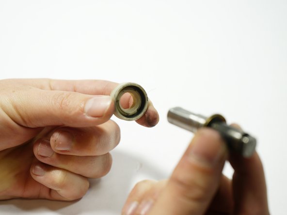

  5. Hitachi HB-B102 Automatic Home Bakery  II Seal Replacement: crwdns2935265:05crwdnd2935265:01crwdnd2935265:02crwdne2935265:0 Hitachi HB-B102 Automatic Home Bakery  II Seal Replacement: crwdns2935265:05crwdnd2935265:02crwdnd2935265:02crwdne2935265:0
    • Use a rubber mallet or other blunt object to push the bolt until it is flush with the seal.

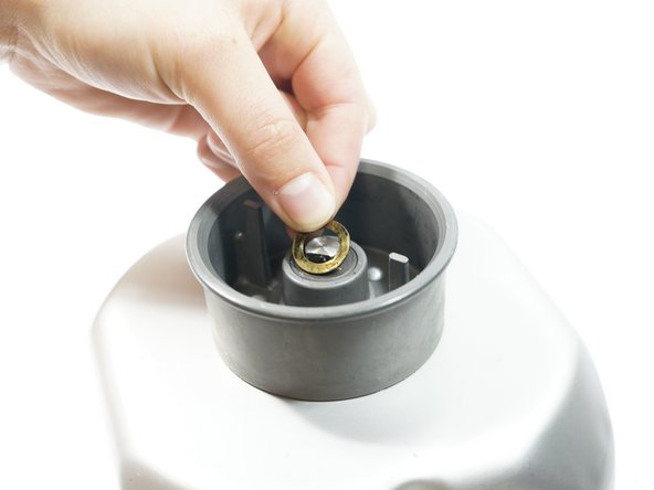

  6. Hitachi HB-B102 Automatic Home Bakery  II Seal Replacement: crwdns2935265:06crwdnd2935265:01crwdnd2935265:03crwdne2935265:0 Hitachi HB-B102 Automatic Home Bakery  II Seal Replacement: crwdns2935265:06crwdnd2935265:02crwdnd2935265:03crwdne2935265:0 Hitachi HB-B102 Automatic Home Bakery  II Seal Replacement: crwdns2935265:06crwdnd2935265:03crwdnd2935265:03crwdne2935265:0
    • Flip the bread pan over and remove the bolt by hand or plyers if necessary. Remove the seal and replace with a new one. Make sure the seal is oriented the correct direction (refer to the picture)
