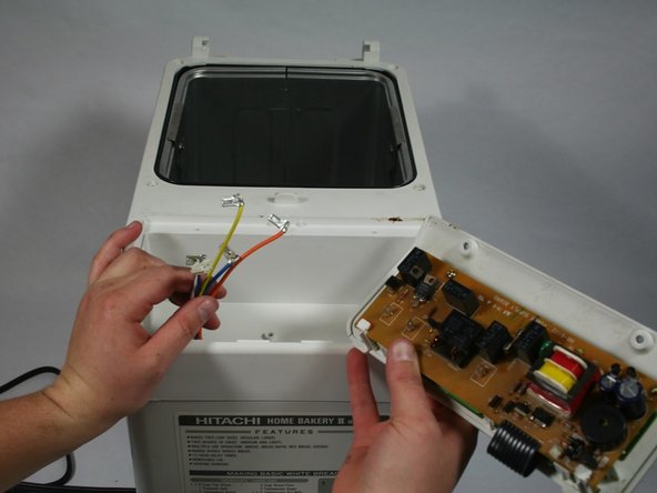

    • Next, remove the two 1.3cm screws that hold on the control panel with a #2 Phillips head screwdriver. These screws, and the rest of the screws in this guide can all be removed using a #2 Phillips head screwdriver.
    • Then pull the control panel out of the device by using a metal spudger to pry it up. Flip it over and look at the back of the motherboard.

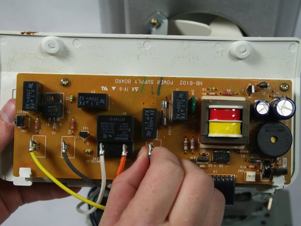

  3. Hitachi HB-B102 Automatic Home Bakery  II Motor Replacement: crwdns2935265:03crwdnd2935265:01crwdnd2935265:03crwdne2935265:0 Hitachi HB-B102 Automatic Home Bakery  II Motor Replacement: crwdns2935265:03crwdnd2935265:02crwdnd2935265:03crwdne2935265:0 Hitachi HB-B102 Automatic Home Bakery  II Motor Replacement: crwdns2935265:03crwdnd2935265:03crwdnd2935265:03crwdne2935265:0
    • You will then have to disconnect the six wires that connect the motherboard to the device. This can be done by firmly grasping a connector and pulling straight out from the unit. Once all of the wires have been disconnected, set aside the control unit.

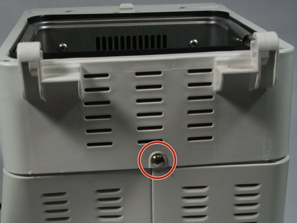

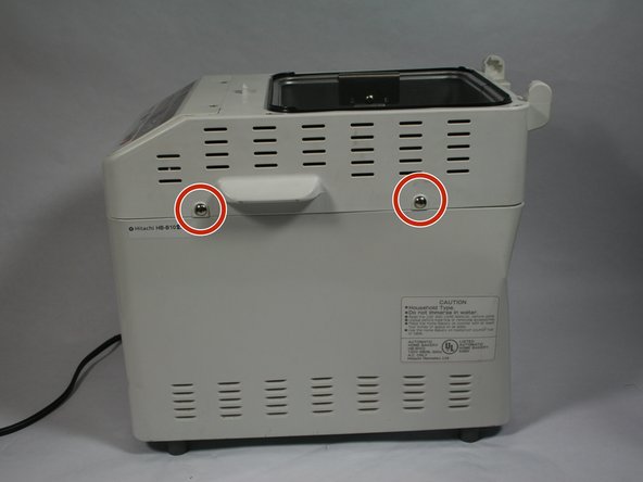

    • Remove the five 1cm screws that hold the the casing together. There will be two on each side, and one on the back.

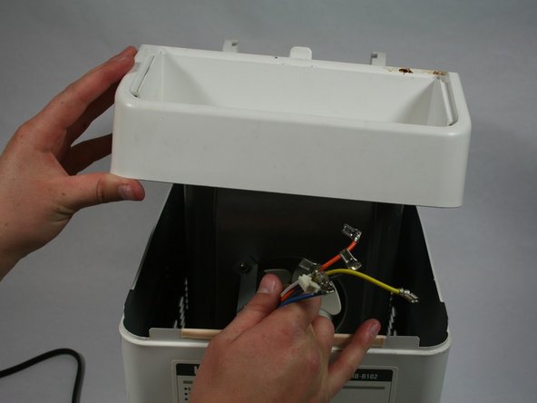

    • Now you can remove the top part of the assembly off by pulling straight up. Don't forget to gently pull your wires through.

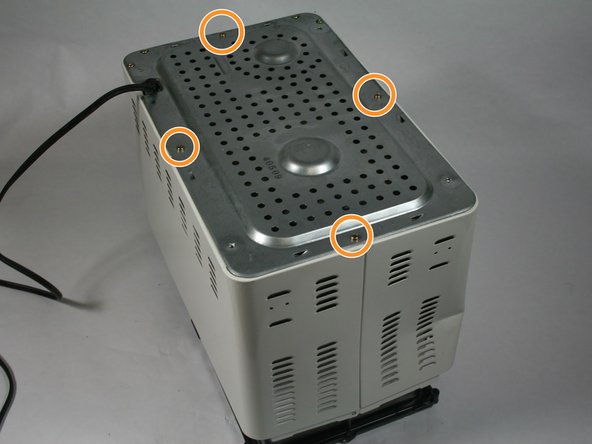

    • Flip the machine over so that the bottom is facing straight up. Then unscrew the four feet on the device with a #2 Phillips head screwdriver. The screws will stay in the rubber feet.
    • Next, remove the four 8mm screws on the four sides of the machine. You do not need to unscrew the screws on the front end corners.
    • Once the feet and screws are undone gently pull the metal plate off.

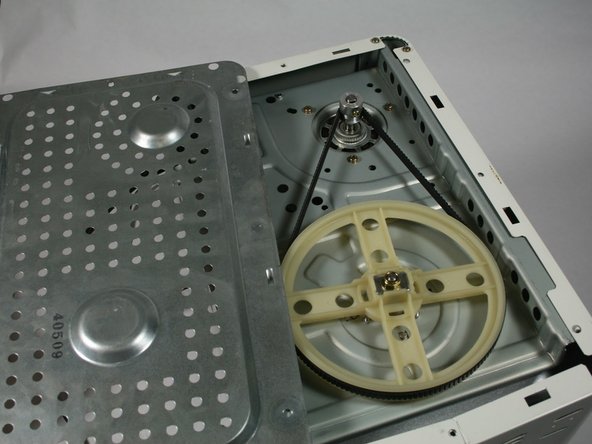

    • Now that the bottom plate and top housing are off, you can gently pull the inner components out of the outer metal housing . This can be done by grabbing hold of the bread pan casing and slowly lifting the entire inner assembly straight up.
    • You now have access to the belt and motor.

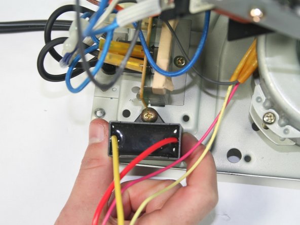

  9. Hitachi HB-B102 Automatic Home Bakery  II Motor Replacement, Motor: crwdns2935265:09crwdnd2935265:01crwdnd2935265:03crwdne2935265:0 Hitachi HB-B102 Automatic Home Bakery  II Motor Replacement, Motor: crwdns2935265:09crwdnd2935265:02crwdnd2935265:03crwdne2935265:0 Hitachi HB-B102 Automatic Home Bakery  II Motor Replacement, Motor: crwdns2935265:09crwdnd2935265:03crwdnd2935265:03crwdne2935265:0

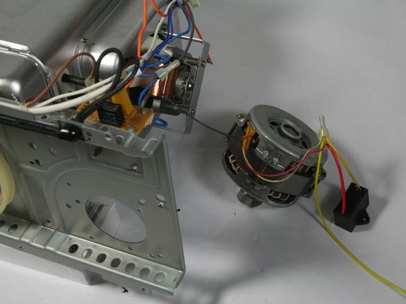

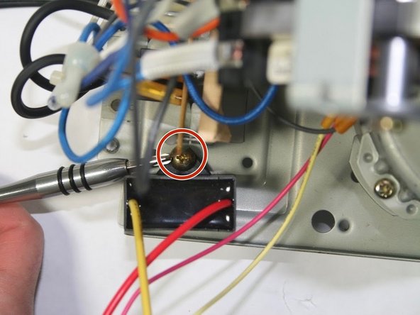

    • Locate the capacitor (aka the black box) to the left of the motor). Unscrew the 1cm screw holding the capacitor in place. The screw will stay with the capacitor.
    • Lift the capacitor and place to the side.

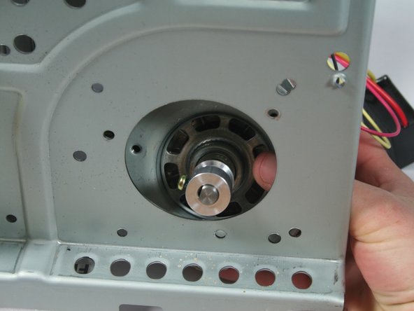

    • Unscrew the three 6mm screws holding the motor to the metal plate.
    • Gently pull the motor away from the metal plate.
  11. Hitachi HB-B102 Automatic Home Bakery  II Motor Replacement: crwdns2935265:011crwdnd2935265:01crwdnd2935265:03crwdne2935265:0 Hitachi HB-B102 Automatic Home Bakery  II Motor Replacement: crwdns2935265:011crwdnd2935265:02crwdnd2935265:03crwdne2935265:0 Hitachi HB-B102 Automatic Home Bakery  II Motor Replacement: crwdns2935265:011crwdnd2935265:03crwdnd2935265:03crwdne2935265:0

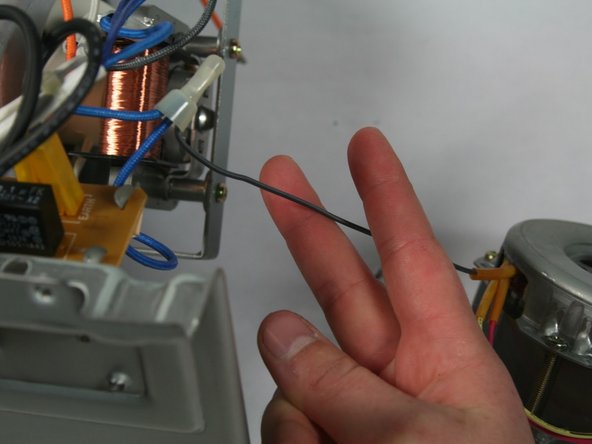

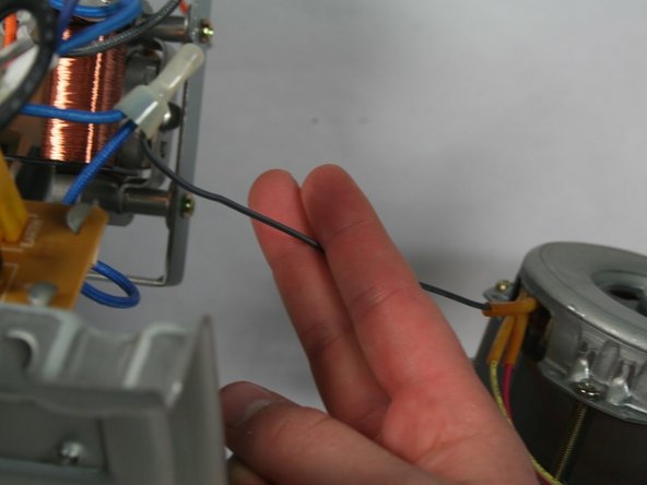

    • Now that you have the motor out, locate the black cable coming out of the motor and linking it to two blue cables.
    • You'll need to cut this wire with scissors or wire cutters.
    • Next, you'll need to wire in your new motor. To do this follow this handy guide: Wire Stripping and Crimping 101

The motor is freely turned, though the motor pulley never moves. Could the 8 micro farad motor capacitor bu bad…how do I test it?
