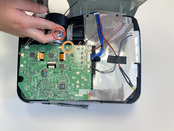

  3. Hitachi CP-X440 Sensor Replacement: crwdns2935265:03crwdnd2935265:01crwdnd2935265:03crwdne2935265:0 Hitachi CP-X440 Sensor Replacement: crwdns2935265:03crwdnd2935265:02crwdnd2935265:03crwdne2935265:0 Hitachi CP-X440 Sensor Replacement: crwdns2935265:03crwdnd2935265:03crwdnd2935265:03crwdne2935265:0
    • You will now be able to pop the top of the projector off.
    • To uncollapse the projector top fully from the projector, you can pull the black cord from the white holder near the lens, circled in red and orange.

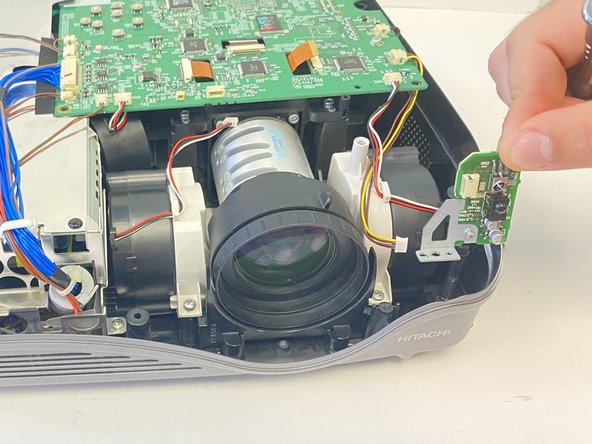

    • With front of projector now facing you, the sensor can be found on the left of the lens.

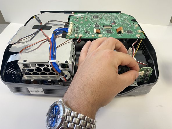

  4. Hitachi CP-X440 Sensor Replacement: crwdns2935265:04crwdnd2935265:01crwdnd2935265:02crwdne2935265:0 Hitachi CP-X440 Sensor Replacement: crwdns2935265:04crwdnd2935265:02crwdnd2935265:02crwdne2935265:0
    • The sensor will be held into the projector by a silver screw on the lower left side of lens. This single 2 mm screw will need to be unscrewed and removed. This will allow you to remove the sensor piece completely out of the projector.
    • You now will remove the sensor piece completely.

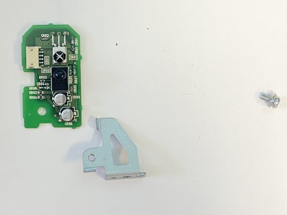

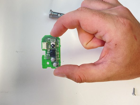

  5. Hitachi CP-X440 Sensor Replacement: crwdns2935265:05crwdnd2935265:01crwdnd2935265:03crwdne2935265:0 Hitachi CP-X440 Sensor Replacement: crwdns2935265:05crwdnd2935265:02crwdnd2935265:03crwdne2935265:0 Hitachi CP-X440 Sensor Replacement: crwdns2935265:05crwdnd2935265:03crwdnd2935265:03crwdne2935265:0
    • To get the sensor piece alone, you will unscrew the single 3 mm silver screw.
    • Once this screw in the sensor piece is removed, the sensor piece will be alone and can be replaced with your new one.
