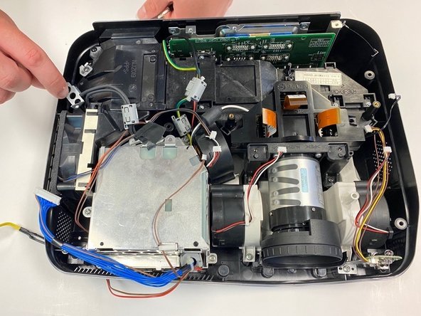

  6. Hitachi CP-X440 Power Supply Unit Replacement: crwdns2935265:06crwdnd2935265:01crwdnd2935265:01crwdne2935265:0
    • Remove the 5 silver 0.5 cm screws on the circuit board with a Phillips #2 Screwdriver.
  7. Hitachi CP-X440 Power Supply Unit Replacement: crwdns2935265:07crwdnd2935265:01crwdnd2935265:01crwdne2935265:0
    • Remove the motherboard so the projector is exposed.

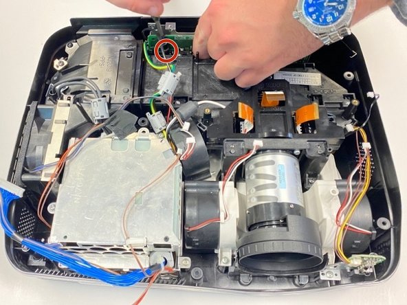

  8. Hitachi CP-X440 Power Supply Unit Replacement, Power Supply Unit: crwdns2935265:08crwdnd2935265:01crwdnd2935265:02crwdne2935265:0 Hitachi CP-X440 Power Supply Unit Replacement, Power Supply Unit: crwdns2935265:08crwdnd2935265:02crwdnd2935265:02crwdne2935265:0
    • Remove the silver plastic protective piece from the top of the power supply unit.
    • Remove the black pin holder by using the spudger.

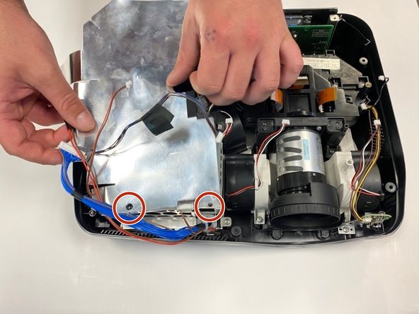

  9. Hitachi CP-X440 Power Supply Unit Replacement: crwdns2935265:09crwdnd2935265:01crwdnd2935265:03crwdne2935265:0 Hitachi CP-X440 Power Supply Unit Replacement: crwdns2935265:09crwdnd2935265:02crwdnd2935265:03crwdne2935265:0 Hitachi CP-X440 Power Supply Unit Replacement: crwdns2935265:09crwdnd2935265:03crwdnd2935265:03crwdne2935265:0

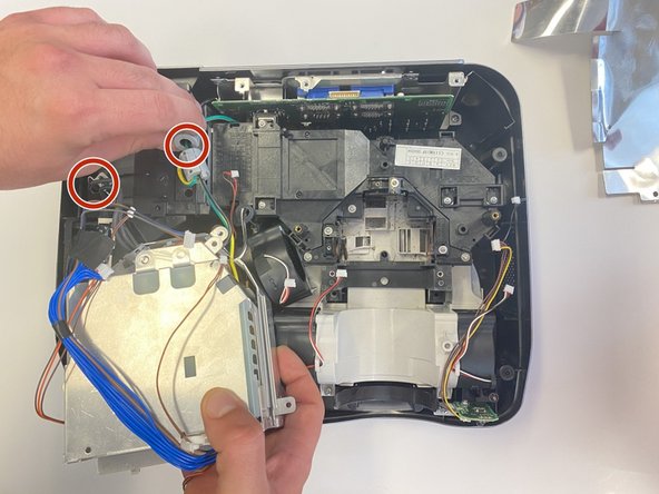

    • Next unscrew all of the 1 cm screws that are holding the power supply unit to the projector.

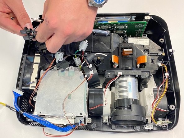

  10. Hitachi CP-X440 Power Supply Unit Replacement: crwdns2935265:010crwdnd2935265:01crwdnd2935265:02crwdne2935265:0 Hitachi CP-X440 Power Supply Unit Replacement: crwdns2935265:010crwdnd2935265:02crwdnd2935265:02crwdne2935265:0
    • Next, remove the wires that are attached to the projector from the power supply unit.

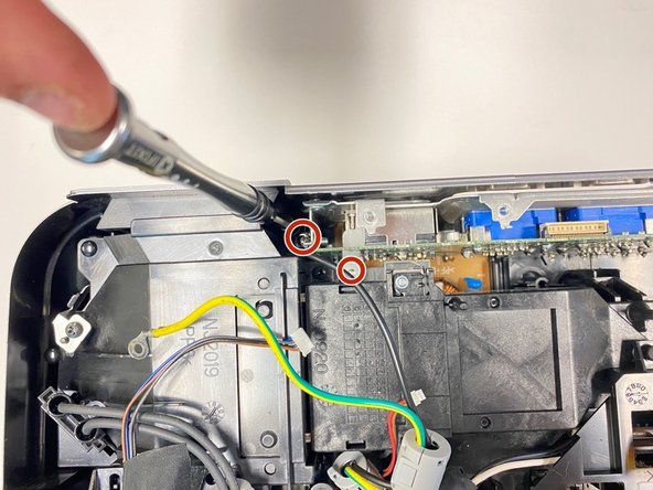

  11. Hitachi CP-X440 Power Supply Unit Replacement: crwdns2935265:011crwdnd2935265:01crwdnd2935265:03crwdne2935265:0 Hitachi CP-X440 Power Supply Unit Replacement: crwdns2935265:011crwdnd2935265:02crwdnd2935265:03crwdne2935265:0 Hitachi CP-X440 Power Supply Unit Replacement: crwdns2935265:011crwdnd2935265:03crwdnd2935265:03crwdne2935265:0
    • Remove the black wire by using the Phillips head #2 screw driver to unscrew the 1 cm screw.
    • Once the screw is out, pull on the metal bracket which should come free, and then pull the wire up so it is released.

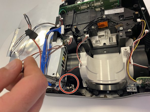

  12. Hitachi CP-X440 Power Supply Unit Replacement: crwdns2935265:012crwdnd2935265:01crwdnd2935265:03crwdne2935265:0 Hitachi CP-X440 Power Supply Unit Replacement: crwdns2935265:012crwdnd2935265:02crwdnd2935265:03crwdne2935265:0 Hitachi CP-X440 Power Supply Unit Replacement: crwdns2935265:012crwdnd2935265:03crwdnd2935265:03crwdne2935265:0
    • Remove the black wire by using the Phillips head #2 screw driver to unscrew the 1 cm silver screw.
    • Once the screw is out, pull on the metal bracket which should come free. Then pull the wire up so it is released.
    • The third picture marks where the base of the second picture's screw is located.

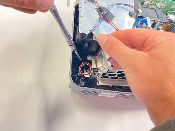

  13. Hitachi CP-X440 Power Supply Unit Replacement: crwdns2935265:013crwdnd2935265:01crwdnd2935265:01crwdne2935265:0
    • Unscrew the last 1 cm screw to the secondary mother board using the Phillips #2 Screwdriver and the Power supply unit will lift free.
