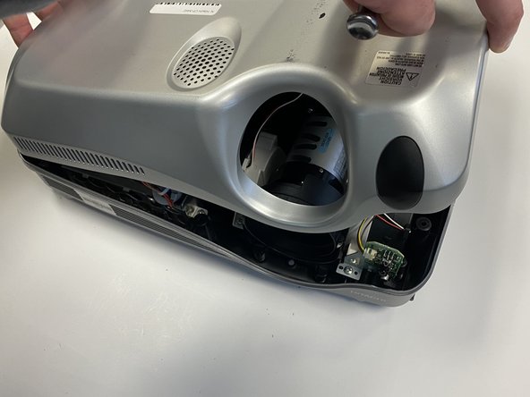

    • Now turn the projector so the front is facing you.
    • Gently remove the lid from the bottom of the projector so the green circuit board is exposed.

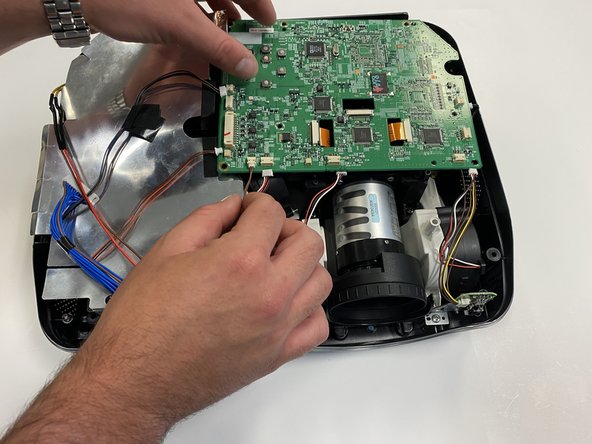

    • Remove the five silver 5 mm screws on the circuit board with a Phillips #2 screwdriver.
  7. Hitachi CP-X440 Lens Replacement: crwdns2935265:07crwdnd2935265:01crwdnd2935265:01crwdne2935265:0
    • Remove the motherboard so the projector is exposed.

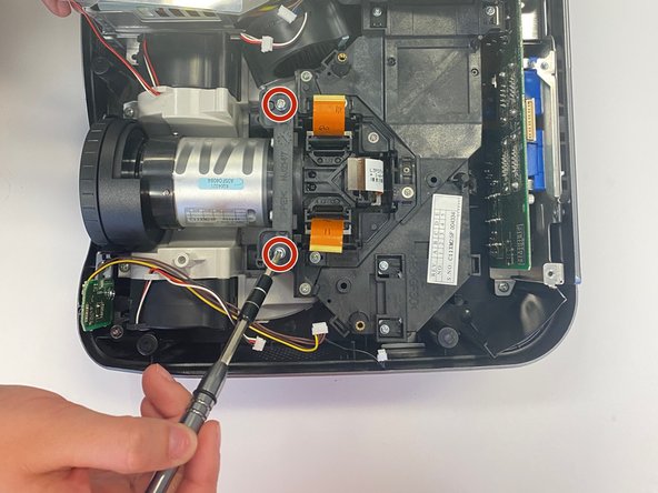

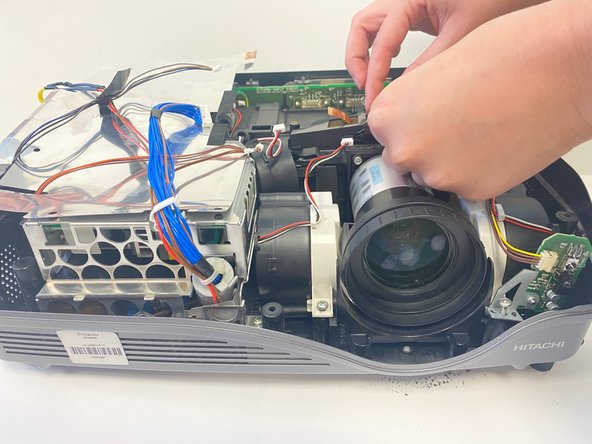

    • As you look at the the device overhead, you will see three pieces of orange ribbon.
    • Attached to the orange ribbon will be a stabilizer over the lamp.
    • On each side, unscrew the two 1 cm screws with a Phillips #0 Screwdriver.
    • Then remove the piece holding the orange ribbons, called the stabilizer from this point on.

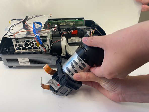

  9. Hitachi CP-X440 Lens Replacement: crwdns2935265:09crwdnd2935265:01crwdnd2935265:03crwdne2935265:0 Hitachi CP-X440 Lens Replacement: crwdns2935265:09crwdnd2935265:02crwdnd2935265:03crwdne2935265:0 Hitachi CP-X440 Lens Replacement: crwdns2935265:09crwdnd2935265:03crwdnd2935265:03crwdne2935265:0

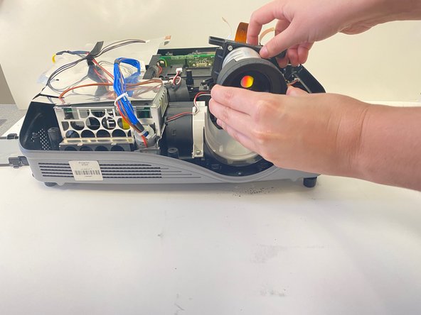

    • Once the stabilizer is removed, set it to the side.
    • Use a Phillips #0 screwdriver to remove the two 1 cm screws on both sides of the lens.
    • The lens element should be easily lifted out of the device.

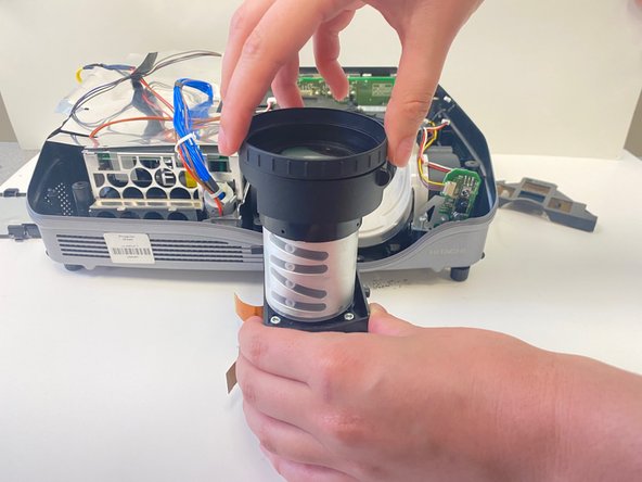

  10. Hitachi CP-X440 Lens Replacement: crwdns2935265:010crwdnd2935265:01crwdnd2935265:02crwdne2935265:0 Hitachi CP-X440 Lens Replacement: crwdns2935265:010crwdnd2935265:02crwdnd2935265:02crwdne2935265:0

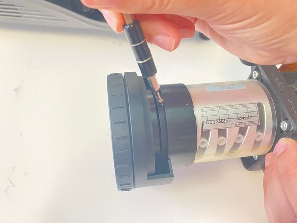

    • Once the lens element is safely removed, you will see 4 tiny 1/2 centimeter screws surrounding the lens.
    • Use a Phillips #000 screwdriver to unscrew each screw. This will allow you to easily remove the lens.
  11. Hitachi CP-X440 Lens Replacement: crwdns2935265:011crwdnd2935265:01crwdnd2935265:03crwdne2935265:0 Hitachi CP-X440 Lens Replacement: crwdns2935265:011crwdnd2935265:02crwdnd2935265:03crwdne2935265:0 Hitachi CP-X440 Lens Replacement: crwdns2935265:011crwdnd2935265:03crwdnd2935265:03crwdne2935265:0
    • Once the lens is safely removed, turn it face up.

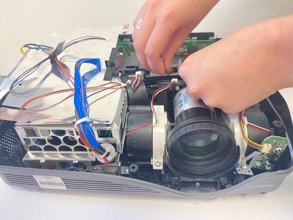

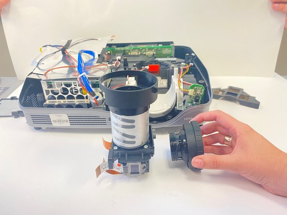

  12. Hitachi CP-X440 Lens Replacement: crwdns2935265:012crwdnd2935265:01crwdnd2935265:02crwdne2935265:0 Hitachi CP-X440 Lens Replacement: crwdns2935265:012crwdnd2935265:02crwdnd2935265:02crwdne2935265:0
    • Begin to gently unscrew the lens by hand, being mindful of light pressure.
    • After a few turns, the lens should be easily removed.
