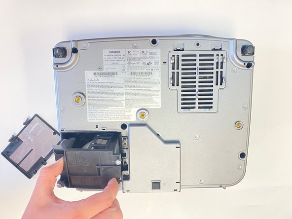

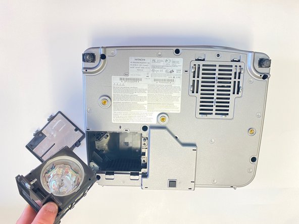

    • Flip the projector upside down so the bottom end is showing and press down the two tabs on the bottom left of the projector
    • Lift the lamp cover up and set to the side
  2. Hitachi CP-X440 Lamp Replacement: crwdns2935265:02crwdnd2935265:01crwdnd2935265:02crwdne2935265:0 Hitachi CP-X440 Lamp Replacement: crwdns2935265:02crwdnd2935265:02crwdnd2935265:02crwdne2935265:0
    • Use a Flathead #4 screwdriver to remove the two 1.0 cm silver screws from the back of the lamp piece.
  3. Hitachi CP-X440 Lamp Replacement: crwdns2935265:03crwdnd2935265:01crwdnd2935265:03crwdne2935265:0 Hitachi CP-X440 Lamp Replacement: crwdns2935265:03crwdnd2935265:02crwdnd2935265:03crwdne2935265:0 Hitachi CP-X440 Lamp Replacement: crwdns2935265:03crwdnd2935265:03crwdnd2935265:03crwdne2935265:0
    • Gently pull the lamp piece out of the projector.
