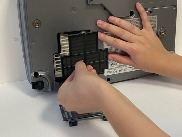

    • Begin with turning the projector on its side so the bottom of the device is clearly visible.
  2. Hitachi CP-X440 Air Filter Replacement: crwdns2935265:02crwdnd2935265:01crwdnd2935265:03crwdne2935265:0 Hitachi CP-X440 Air Filter Replacement: crwdns2935265:02crwdnd2935265:02crwdnd2935265:03crwdne2935265:0 Hitachi CP-X440 Air Filter Replacement: crwdns2935265:02crwdnd2935265:03crwdnd2935265:03crwdne2935265:0
    • In the bottom left hand corner of the device there will be a vent.
    • At the bottom of the vent, there will be two pull tabs. Remove the vent by gently pushing up on the tabs.
    • Once the tabs are pushed, the vent will pop out and will be able to easily be taken off the device.
  3. Hitachi CP-X440 Air Filter Replacement: crwdns2935265:03crwdnd2935265:01crwdnd2935265:02crwdne2935265:0 Hitachi CP-X440 Air Filter Replacement: crwdns2935265:03crwdnd2935265:02crwdnd2935265:02crwdne2935265:0
    • Once the vent is removed, you will see the black air filter.
    • To remove the air filter, gently grab the center handle and pull.
    • The air filter can be discarded into a waste basket.
