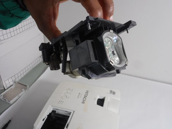

    • Locate Bulb Slot at the back corner of the projector with one screw on the side of the cover.
  2. Hitachi CP-X2511 Projector Bulb Replacement: crwdns2935265:02crwdnd2935265:01crwdnd2935265:01crwdne2935265:0
    • Using a Philips head screwdriver unscrew the cover that is over the Bulb itself then remove the cover using your hand.
  3. Hitachi CP-X2511 Projector Bulb Replacement: crwdns2935265:03crwdnd2935265:01crwdnd2935265:01crwdne2935265:0
    • After removing the cover loosen the screws in the corners of the Projector Bulb.
  4. Hitachi CP-X2511 Projector Bulb Replacement: crwdns2935265:04crwdnd2935265:01crwdnd2935265:02crwdne2935265:0 Hitachi CP-X2511 Projector Bulb Replacement: crwdns2935265:04crwdnd2935265:02crwdnd2935265:02crwdne2935265:0
    • Lift out worn bulb using black handle at the top and replace with new bulb.
