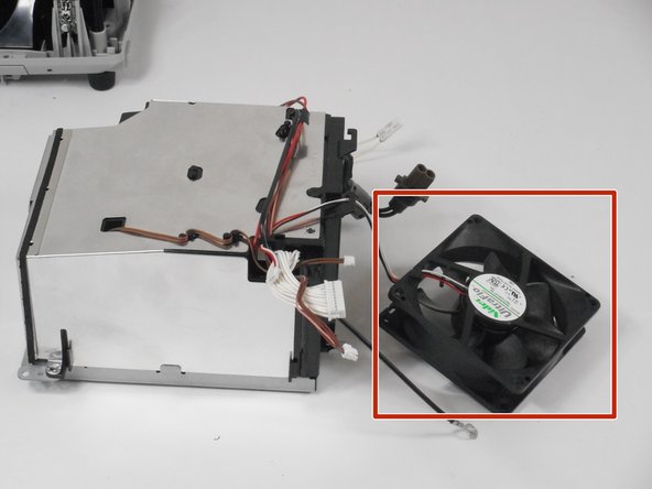

Hitachi CP-X2511 Fan Replacement
  1. Hitachi CP-X2511 Fan Replacement, Fan: crwdns2935265:01crwdnd2935265:01crwdnd2935265:01crwdne2935265:0
    • To get to the fan you must take out the screws that are holding in the power source.
  2. Hitachi CP-X2511 Fan Replacement: crwdns2935265:02crwdnd2935265:01crwdnd2935265:03crwdne2935265:0 Hitachi CP-X2511 Fan Replacement: crwdns2935265:02crwdnd2935265:02crwdnd2935265:03crwdne2935265:0 Hitachi CP-X2511 Fan Replacement: crwdns2935265:02crwdnd2935265:03crwdnd2935265:03crwdne2935265:0
    • You must make sure all screws are out and wire are unplug.
  3. Hitachi CP-X2511 Fan Replacement: crwdns2935265:03crwdnd2935265:01crwdnd2935265:02crwdne2935265:0 Hitachi CP-X2511 Fan Replacement: crwdns2935265:03crwdnd2935265:02crwdnd2935265:02crwdne2935265:0
    • Once unscrewed it is easy to slide out the fan and power source to replace.
