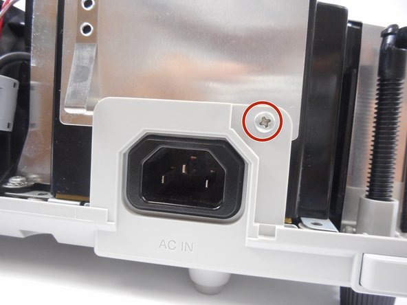

    • Now unscrew the nickel screw located by the front of the lens and then the other one by the power cord port.
  5. Hitachi CP-X2511 Battery Replacement: crwdns2935265:05crwdnd2935265:01crwdnd2935265:01crwdne2935265:0
    • Pull the battery and fan out of the projector and replace the whole thing.
