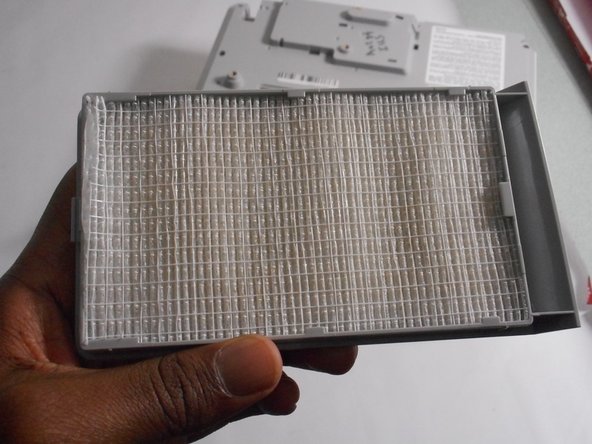

    • Locate Air Filter slot at the bottom of projector by turning over the projector and looking under the lens.
  2. Hitachi CP-X2511 Air Filter Replacement: crwdns2935265:02crwdnd2935265:01crwdnd2935265:02crwdne2935265:0 Hitachi CP-X2511 Air Filter Replacement: crwdns2935265:02crwdnd2935265:02crwdnd2935265:02crwdne2935265:0
    • Pull the tab at the front of the slot to open the slot using handle in the front of it, revealing the air filter.

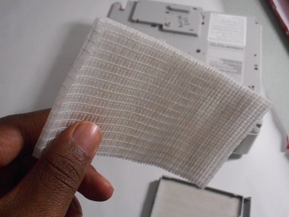

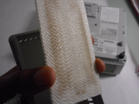

  3. Hitachi CP-X2511 Air Filter Replacement: crwdns2935265:03crwdnd2935265:01crwdnd2935265:03crwdne2935265:0 Hitachi CP-X2511 Air Filter Replacement: crwdns2935265:03crwdnd2935265:02crwdnd2935265:03crwdne2935265:0 Hitachi CP-X2511 Air Filter Replacement: crwdns2935265:03crwdnd2935265:03crwdnd2935265:03crwdne2935265:0
    • Remove the dirty filter from the slot using your hand and replace with new clean filter by putting it in the slot using your hand.
