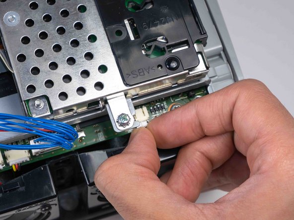

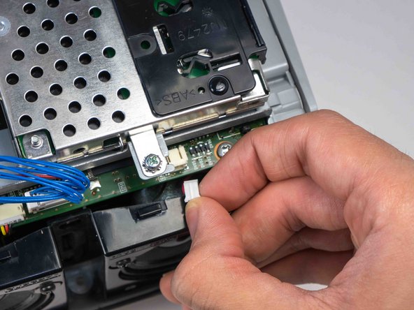

  6. Hitachi CP-X2010N Speaker Replacement, Speaker: crwdns2935265:06crwdnd2935265:01crwdnd2935265:03crwdne2935265:0 Hitachi CP-X2010N Speaker Replacement, Speaker: crwdns2935265:06crwdnd2935265:02crwdnd2935265:03crwdne2935265:0 Hitachi CP-X2010N Speaker Replacement, Speaker: crwdns2935265:06crwdnd2935265:03crwdnd2935265:03crwdne2935265:0
    • Pinch the edges of the two connectors and carefully disconnect both wires from the motherboard.

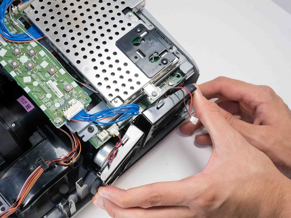

  7. Hitachi CP-X2010N Speaker Replacement: crwdns2935265:07crwdnd2935265:01crwdnd2935265:03crwdne2935265:0 Hitachi CP-X2010N Speaker Replacement: crwdns2935265:07crwdnd2935265:02crwdnd2935265:03crwdne2935265:0 Hitachi CP-X2010N Speaker Replacement: crwdns2935265:07crwdnd2935265:03crwdnd2935265:03crwdne2935265:0

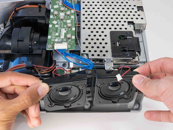

    • Lightly grab the speakers and pull them up and towards yourself to remove the speakers from the case.
    • For reassembly, pinch the sides of the speakers together to line up middle slot first and then line up outer slots.
