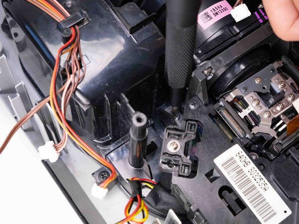

  15. Hitachi CP-X2010N Lens Replacement, Lens: crwdns2935265:015crwdnd2935265:01crwdnd2935265:03crwdne2935265:0 Hitachi CP-X2010N Lens Replacement, Lens: crwdns2935265:015crwdnd2935265:02crwdnd2935265:03crwdne2935265:0 Hitachi CP-X2010N Lens Replacement, Lens: crwdns2935265:015crwdnd2935265:03crwdnd2935265:03crwdne2935265:0

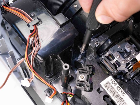

    • Use a Phillips #2 screwdriver to remove the three black 14 mm screws holding down the projector housing.

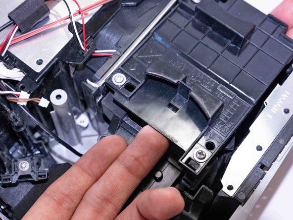

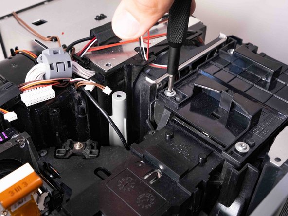

  16. Hitachi CP-X2010N Lens Replacement: crwdns2935265:016crwdnd2935265:01crwdnd2935265:02crwdne2935265:0 Hitachi CP-X2010N Lens Replacement: crwdns2935265:016crwdnd2935265:02crwdnd2935265:02crwdne2935265:0
    • Loosen the three silver Phillips #2 screws that secure the lamp housing.
    • The screws are captive and do not need to be removed from the lamp housing.

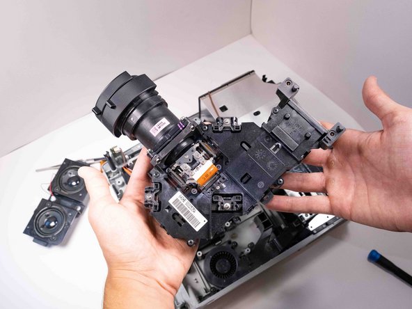

  17. Hitachi CP-X2010N Lens Replacement: crwdns2935265:017crwdnd2935265:01crwdnd2935265:02crwdne2935265:0 Hitachi CP-X2010N Lens Replacement: crwdns2935265:017crwdnd2935265:02crwdnd2935265:02crwdne2935265:0
    • Work the projector housing loose from the two pins on the lamp housing.

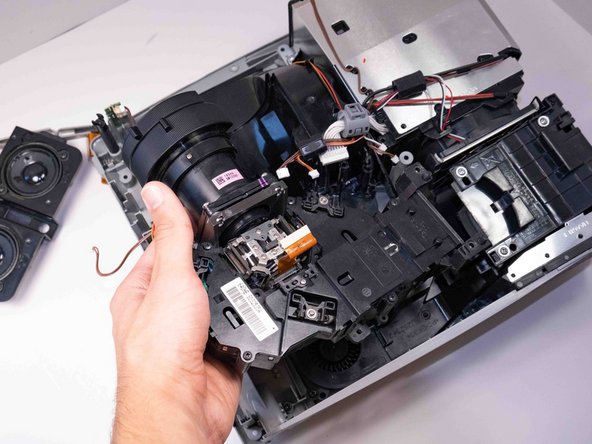

  18. Hitachi CP-X2010N Lens Replacement: crwdns2935265:018crwdnd2935265:01crwdnd2935265:03crwdne2935265:0 Hitachi CP-X2010N Lens Replacement: crwdns2935265:018crwdnd2935265:02crwdnd2935265:03crwdne2935265:0 Hitachi CP-X2010N Lens Replacement: crwdns2935265:018crwdnd2935265:03crwdnd2935265:03crwdne2935265:0
    • Lift the projector housing up from the left side and remove it from the case.

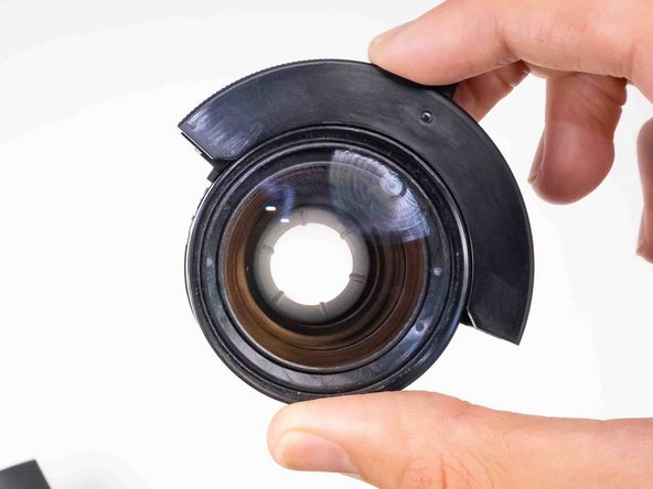

  19. Hitachi CP-X2010N Lens Replacement: crwdns2935265:019crwdnd2935265:01crwdnd2935265:03crwdne2935265:0 Hitachi CP-X2010N Lens Replacement: crwdns2935265:019crwdnd2935265:02crwdnd2935265:03crwdne2935265:0 Hitachi CP-X2010N Lens Replacement: crwdns2935265:019crwdnd2935265:03crwdnd2935265:03crwdne2935265:0

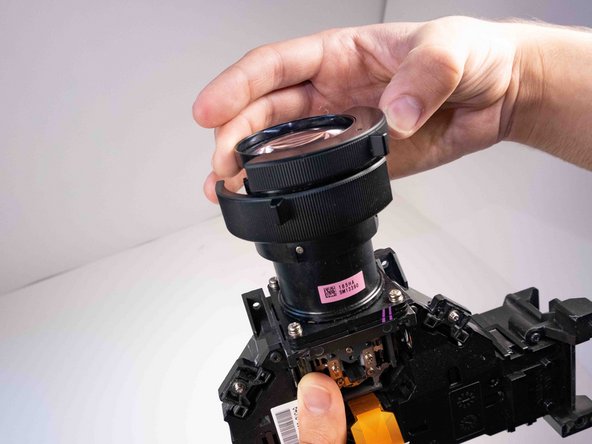

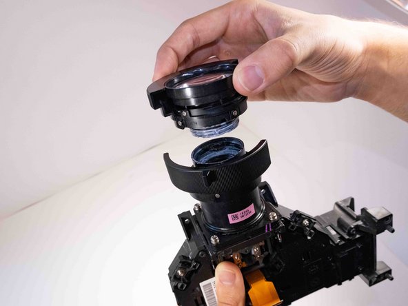

    • Turn the front lens element counterclockwise and lift it off the projector housing.
    • The front element will have lubricant on the inside shaft. Take care not to rub any of it off.
  20. Hitachi CP-X2010N Lens Replacement: crwdns2935265:020crwdnd2935265:01crwdnd2935265:03crwdne2935265:0 Hitachi CP-X2010N Lens Replacement: crwdns2935265:020crwdnd2935265:02crwdnd2935265:03crwdne2935265:0 Hitachi CP-X2010N Lens Replacement: crwdns2935265:020crwdnd2935265:03crwdnd2935265:03crwdne2935265:0

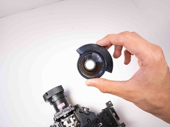

    • Inspect all glass elements for debris or damage.
    • Clean or replace the lens as needed.
