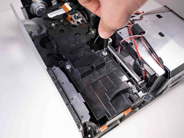

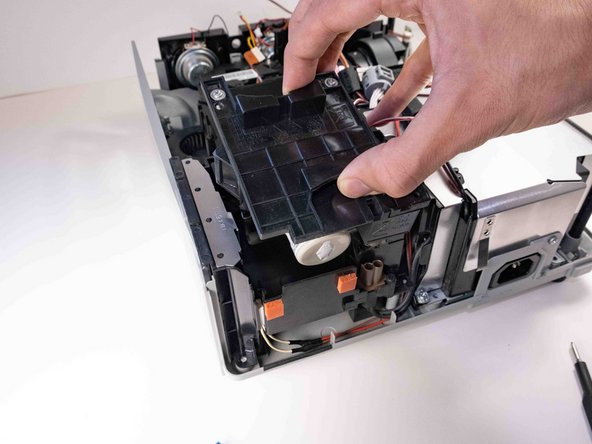

    • Using a Phillips #2 screwdriver, loosen three silver captive screws from lamp housing.
    • The screws are captive and do not need to be removed from the housing.

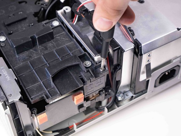

    • Use a Phillips #2 screwdriver to remove the black 12 mm screw holding the housing to the lamp's brown power connector.

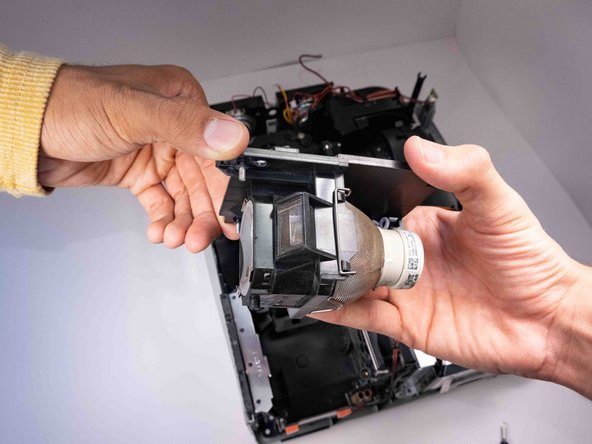

    • Remove the lamp from its housing.

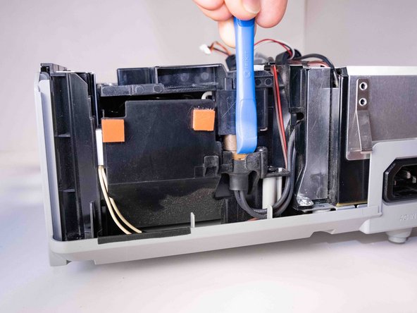

    • You may need to use an iFixit opening tool to loosen the brown power cord from its connector.
  18. Hitachi CP-X2010N Lamp Replacement: crwdns2935265:018crwdnd2935265:01crwdnd2935265:02crwdne2935265:0 Hitachi CP-X2010N Lamp Replacement: crwdns2935265:018crwdnd2935265:02crwdnd2935265:02crwdne2935265:0
    • Inspect the lamp for debris or damage.
    • Clean or replace the lamp as needed.
