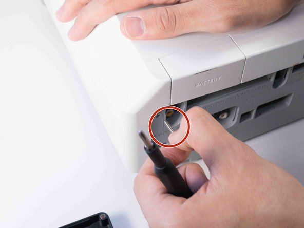

    • Flip the projector upside down to expose the screws on the underside.
  2. Hitachi CP-X2010N  Motherboard Replacement: crwdns2935265:02crwdnd2935265:01crwdnd2935265:03crwdne2935265:0 Hitachi CP-X2010N  Motherboard Replacement: crwdns2935265:02crwdnd2935265:02crwdnd2935265:03crwdne2935265:0 Hitachi CP-X2010N  Motherboard Replacement: crwdns2935265:02crwdnd2935265:03crwdnd2935265:03crwdne2935265:0
    • Use a Phillips #2 screwdriver to remove eight black 14 mm screws holding the top panel to the main projector body.

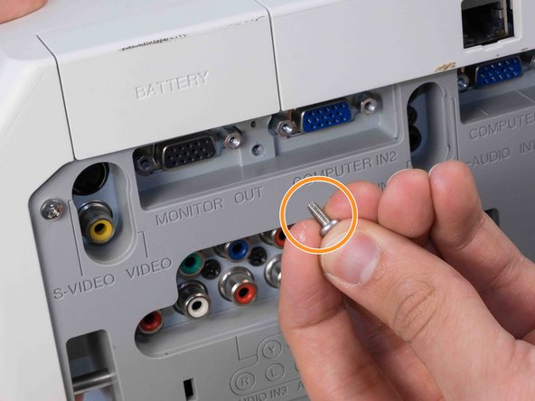

    • Flip projector right side up and orient it so you are facing the rear panel.

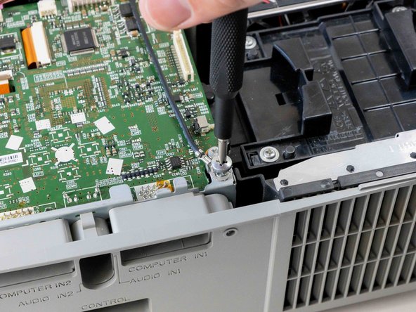

  4. Hitachi CP-X2010N  Motherboard Replacement: crwdns2935265:04crwdnd2935265:01crwdnd2935265:03crwdne2935265:0 Hitachi CP-X2010N  Motherboard Replacement: crwdns2935265:04crwdnd2935265:02crwdnd2935265:03crwdne2935265:0 Hitachi CP-X2010N  Motherboard Replacement: crwdns2935265:04crwdnd2935265:03crwdnd2935265:03crwdne2935265:0
    • Use a Phillips #2 screwdriver to remove two silver 22 mm long screws.
    • Use a Phillips #2 screwdriver to remove the short silver 10 mm screw.

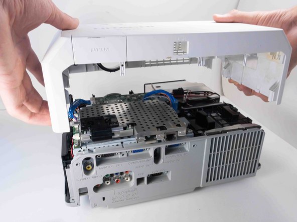

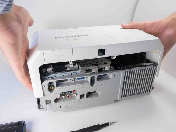

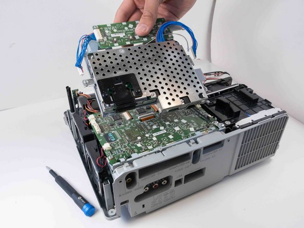

  5. Hitachi CP-X2010N  Motherboard Replacement: crwdns2935265:05crwdnd2935265:01crwdnd2935265:03crwdne2935265:0 Hitachi CP-X2010N  Motherboard Replacement: crwdns2935265:05crwdnd2935265:02crwdnd2935265:03crwdne2935265:0 Hitachi CP-X2010N  Motherboard Replacement: crwdns2935265:05crwdnd2935265:03crwdnd2935265:03crwdne2935265:0
    • Carefully lift the top panel from the body of the projector, making sure it doesn't catch on anything.
    • Remove the panel from the body of the projector.

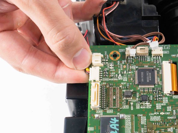

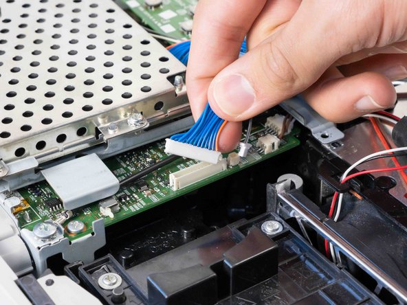

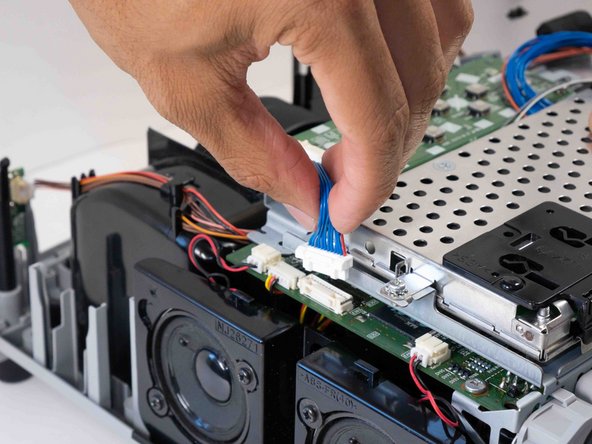

  6. Hitachi CP-X2010N  Motherboard Replacement, Motherboard: crwdns2935265:06crwdnd2935265:01crwdnd2935265:03crwdne2935265:0 Hitachi CP-X2010N  Motherboard Replacement, Motherboard: crwdns2935265:06crwdnd2935265:02crwdnd2935265:03crwdne2935265:0 Hitachi CP-X2010N  Motherboard Replacement, Motherboard: crwdns2935265:06crwdnd2935265:03crwdnd2935265:03crwdne2935265:0
    • Carefully pinch the edges of the two blue connectors and pull upwards to remove them from the motherboard.
    • Carefully pinch and remove the small gray connector next to the blue wire opposite the speakers.

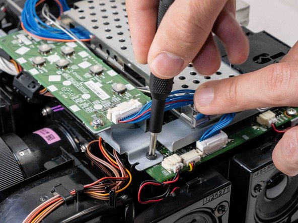

  7. Hitachi CP-X2010N  Motherboard Replacement: crwdns2935265:07crwdnd2935265:01crwdnd2935265:03crwdne2935265:0 Hitachi CP-X2010N  Motherboard Replacement: crwdns2935265:07crwdnd2935265:02crwdnd2935265:03crwdne2935265:0 Hitachi CP-X2010N  Motherboard Replacement: crwdns2935265:07crwdnd2935265:03crwdnd2935265:03crwdne2935265:0

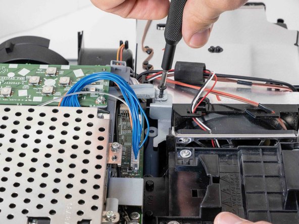

    • Use a Phillips #2 screwdriver to remove the two black 14 mm screws securing the button array.
    • Move the wires for better access to the screws if needed.

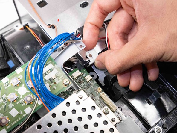

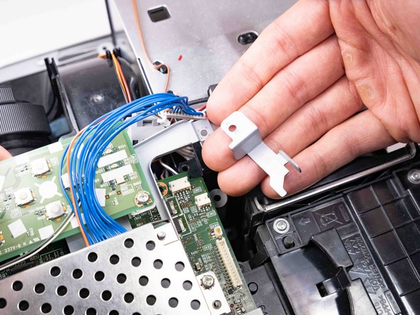

  8. Hitachi CP-X2010N  Motherboard Replacement: crwdns2935265:08crwdnd2935265:01crwdnd2935265:03crwdne2935265:0 Hitachi CP-X2010N  Motherboard Replacement: crwdns2935265:08crwdnd2935265:02crwdnd2935265:03crwdne2935265:0 Hitachi CP-X2010N  Motherboard Replacement: crwdns2935265:08crwdnd2935265:03crwdnd2935265:03crwdne2935265:0
    • Remove the bracket that was being held by the screw.
    • Take a picture or memorize its orientation for easier reinstallation.

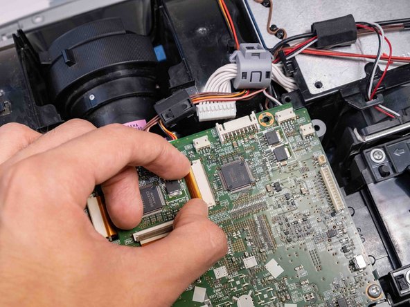

  12. Hitachi CP-X2010N  Motherboard Replacement: crwdns2935265:012crwdnd2935265:01crwdnd2935265:03crwdne2935265:0 Hitachi CP-X2010N  Motherboard Replacement: crwdns2935265:012crwdnd2935265:02crwdnd2935265:03crwdne2935265:0 Hitachi CP-X2010N  Motherboard Replacement: crwdns2935265:012crwdnd2935265:03crwdnd2935265:03crwdne2935265:0

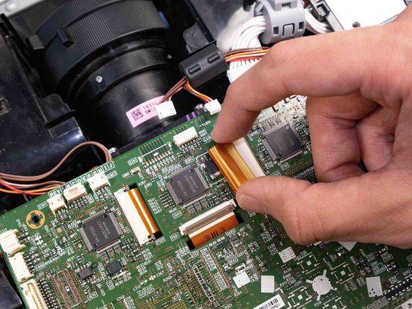

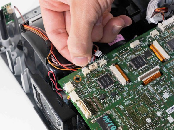

    • Delicately pinch and pull off all the wired connections surrounding the outside of the motherboard.
  13. Hitachi CP-X2010N  Motherboard Replacement: crwdns2935265:013crwdnd2935265:01crwdnd2935265:03crwdne2935265:0 Hitachi CP-X2010N  Motherboard Replacement: crwdns2935265:013crwdnd2935265:02crwdnd2935265:03crwdne2935265:0 Hitachi CP-X2010N  Motherboard Replacement: crwdns2935265:013crwdnd2935265:03crwdnd2935265:03crwdne2935265:0
    • Use the tip of a spudger or your fingernail to flip up the small locking flap on the three orange cable locks. Then, you can safely pull the cables out.
    • Too much force could break the ribbon cable.

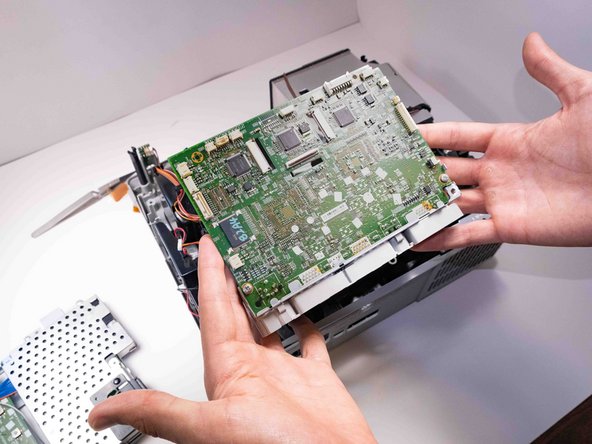

  14. Hitachi CP-X2010N  Motherboard Replacement: crwdns2935265:014crwdnd2935265:01crwdnd2935265:02crwdne2935265:0 Hitachi CP-X2010N  Motherboard Replacement: crwdns2935265:014crwdnd2935265:02crwdnd2935265:02crwdne2935265:0
    • Lift the motherboard out from the projector carefully so that it doesn't catch on any other components.
