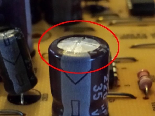

  4. Hisense Television Capacitor Replacement for Boot-Loop Problem, Replacing the bad capacitors: crwdns2935265:04crwdnd2935265:01crwdnd2935265:02crwdne2935265:0 Hisense Television Capacitor Replacement for Boot-Loop Problem, Replacing the bad capacitors: crwdns2935265:04crwdnd2935265:02crwdnd2935265:02crwdne2935265:0
    • Once the circuit board is liberated from the TV, you'll have a chance to get a good look at the capacitors. The main culprits are at the top. If they bulge at the top, there's a good chance that they're blown and need replacing.
    • The particular capacitors I needed for my TV are 10uF 350V. You can purchase capacitors with a higher voltage rating. But, the farad value has to be the same.
    • At this point, it's down to just removing the bad capacitor and installing new ones. I used a solder removal tool not only because the component is flush to the board, it would give me a cleaner soldering surface when installing the new capacitor.
