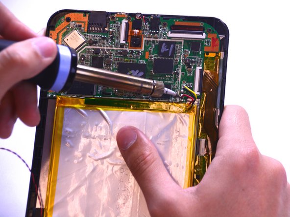

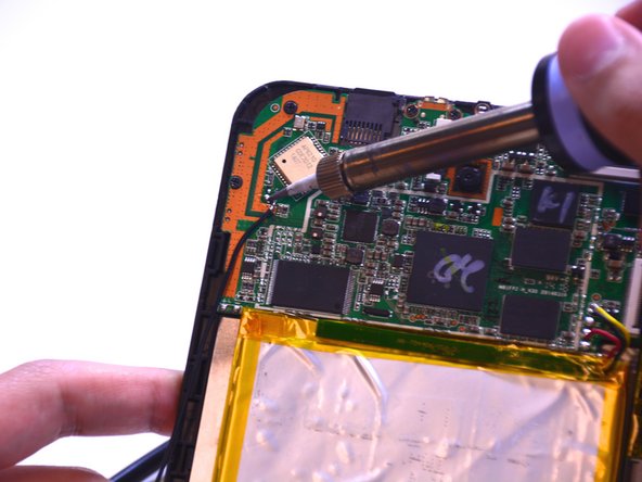

  5. Hisense Sero 8 Motherboard Replacement: crwdns2935265:05crwdnd2935265:01crwdnd2935265:03crwdne2935265:0 Hisense Sero 8 Motherboard Replacement: crwdns2935265:05crwdnd2935265:02crwdnd2935265:03crwdne2935265:0 Hisense Sero 8 Motherboard Replacement: crwdns2935265:05crwdnd2935265:03crwdnd2935265:03crwdne2935265:0
    • Be cautious of the extremely hot tip of the soldering iron.
    • Desolder the red, black, and yellow wires to remove the motherboard. Take a look at this guide to learn how to solder and desolder connections.
    • Desolder the black wire located on the top left of the device.
    • Once desoldered, carefully lift the motherboard out of the device.
