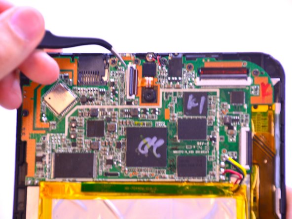

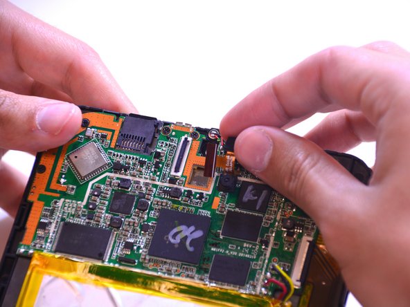

    • Use your fingers to pull the latch upwards to unlock the ribbon cable.
  3. Hisense Sero 8 Front and Back Camera Set Replacement: crwdns2935265:03crwdnd2935265:01crwdnd2935265:03crwdne2935265:0 Hisense Sero 8 Front and Back Camera Set Replacement: crwdns2935265:03crwdnd2935265:02crwdnd2935265:03crwdne2935265:0 Hisense Sero 8 Front and Back Camera Set Replacement: crwdns2935265:03crwdnd2935265:03crwdnd2935265:03crwdne2935265:0
    • Use the pointed end of the spudger to lift the camera from the motherboard.
    • Use tweezers to carefully pull out the camera set.
