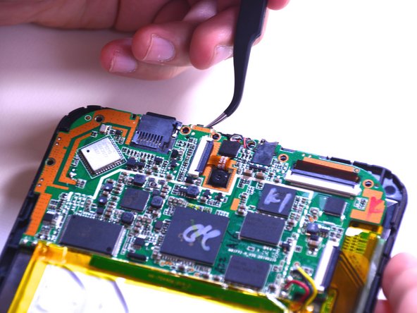

  3. Hisense Sero 8 Charging Port Replacement: crwdns2935265:03crwdnd2935265:01crwdnd2935265:02crwdne2935265:0 Hisense Sero 8 Charging Port Replacement: crwdns2935265:03crwdnd2935265:02crwdnd2935265:02crwdne2935265:0
    • Gently lift the motherboard up to extract the charging port out with the tweezers.
    • Be cautious not to disconnect any wires or ribbon cables.
