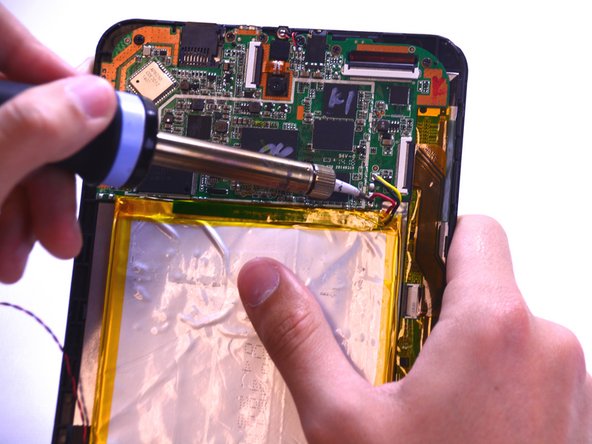

    • Desolder the red, black, and yellow wires to properly remove the motherboard. Take a look at this guide to learn how to solder and desolder connections.

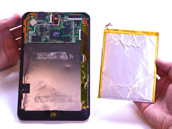

    • Using the spudger, carefully remove the battery by lifting up one corner and pushing the spudger underneath the battery.
    • Now carefully lift the battery off the device.
    • There is double-sided tape that affixes the battery to the device.
    • Be careful to not puncture the battery. This could be a safety hazard.

so i'm fixing this tablet for a friend. the battery was all puffed up. on the battery is printed "HX 3098126 | 3.7V 4000mAh | 14.10.05" on the battery circuit board it says "HX-704406-01A-2". doing a search for hisense sero 8 battery, i could only find one for the sero 7 lt which is only 3400 mAh, and i hear the battery life is already bad on these. so i found one that looks like the proper power rating, but two issues.
1. the dimensions are listed as 90 x 60 x 6 mm. i measured my sero 8 battery and it seems to be about twice the size (120 x 90 mm). not sure about the thickness, but i'm worried that half size would be double thick, keeping the case from closing on it.
2. the replacement has only red/black wires, the sero has a yellow wire labelled N, which i figure might be ground, though some people suggest it could be something to do with the thermal sensor (not specific to this tablet). most said it wouldn't charge unless you wired it to either ground, or the black wire.
http://ebay.to/1IWUAQ6
Lukyan - crwdns2934203:0crwdne2934203:0 crwdns2950251:0crwdne2950251:0
i ordered the battery and both issues came up. it was too thick, but i flattened it a bit with a rolling pin action. the case i have is missing a few tabs so it doesn't close all the way anyway. i put the battery vertically on the bottom left side (back view). anywhere else it would press and make an impression mark when using the LCD.
i could not get it to charge. the original had a Yellow wire (N), in addition to the Red and Black. i tried leaving Yellow disconnected and it powered on, but when i plugged in USB it showed a lightning bolt and said Not Charging.
next i tried putting Yellow to Black (Ground). it did not react to USB. so i removed Yellow again and this time it said Charging but it still wasn't.
only thing i can think is to tie the Yellow to Red, but i'm hesitant to damage the board, as it's a customer's tablet. if anyone else has any ideas on how to get this to charge, let me know. i can provide some pics of the circuit board and batteries if needed. thanks very much in advance.
