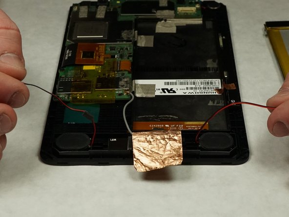

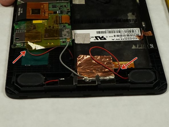

    • Peel back the film holding the speaker wire in place
    • Detach both wire connectors
  5. Hisense Sero 7 Pro Speakers Replacement: crwdns2935265:05crwdnd2935265:01crwdnd2935265:01crwdne2935265:0
    • Using a plastic opening tool, carefully place under one corner of each speaker
    • Remove both speakers
