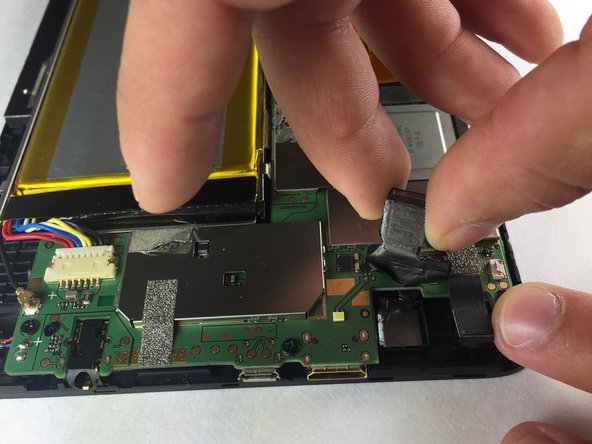

  2. Hisense Sero 7 Pro Rear Camera Replacement: crwdns2935265:02crwdnd2935265:01crwdnd2935265:01crwdne2935265:0
    • Using a metal or nylon spudger, begin to peel the tape from the motherboard that it is attached to the camera.
    • If needed, the same steps can be applied to front camera.

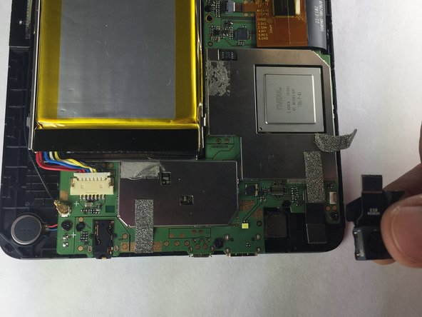

  3. Hisense Sero 7 Pro Rear Camera Replacement: crwdns2935265:03crwdnd2935265:01crwdnd2935265:03crwdne2935265:0 Hisense Sero 7 Pro Rear Camera Replacement: crwdns2935265:03crwdnd2935265:02crwdnd2935265:03crwdne2935265:0 Hisense Sero 7 Pro Rear Camera Replacement: crwdns2935265:03crwdnd2935265:03crwdnd2935265:03crwdne2935265:0
    • Pull the camera toward you to detach from the tablet.
    • Use caution when detaching camera from port.
