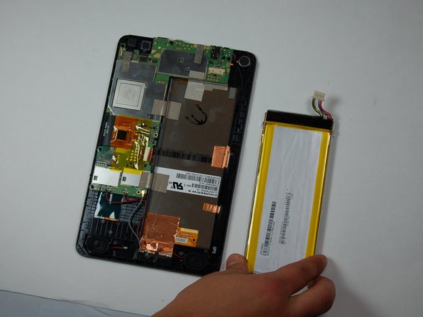

    • Turn tablet off before dissembling it.
    • Use caution when handling device if screen is cracked.
    • Using a plastic opening tool, pry open the back cover from the tablet.
    • An extra set of hands may be required.
  2. Hisense Sero 7 Pro Battery Replacement: crwdns2935265:02crwdnd2935265:01crwdnd2935265:02crwdne2935265:0 Hisense Sero 7 Pro Battery Replacement: crwdns2935265:02crwdnd2935265:02crwdnd2935265:02crwdne2935265:0
    • Use a spudger to disconnect the battery from the motherboard.
  3. Hisense Sero 7 Pro Battery Replacement: crwdns2935265:03crwdnd2935265:01crwdnd2935265:02crwdne2935265:0 Hisense Sero 7 Pro Battery Replacement: crwdns2935265:03crwdnd2935265:02crwdnd2935265:02crwdne2935265:0
    • Using a plastic opening tool, carefully place under one corner of the battery.
    • Move around edges of the battery to lift it off of the tablet.
    • Remove battery from tablet.
