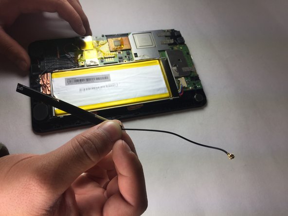

  1. Hisense Sero 7 Pro  GPS Antenna Replacement, GPS Antenna: crwdns2935265:01crwdnd2935265:01crwdnd2935265:02crwdne2935265:0 Hisense Sero 7 Pro  GPS Antenna Replacement, GPS Antenna: crwdns2935265:01crwdnd2935265:02crwdnd2935265:02crwdne2935265:0
    • Turn tablet off before disassembling it.
    • Use caution when handling device if screen is cracked.
    • Using a plastic opening tool, pry open the back cover from the tablet.
    • An extra set of hands may be required.
  2. Hisense Sero 7 Pro  GPS Antenna Replacement: crwdns2935265:02crwdnd2935265:01crwdnd2935265:02crwdne2935265:0 Hisense Sero 7 Pro  GPS Antenna Replacement: crwdns2935265:02crwdnd2935265:02crwdnd2935265:02crwdne2935265:0
    • Pull the Wi-Fi antenna directly upwards to remove it from the motherboard.
    • Be gentle when disconnecting the antenna because it may damage the part it is attached to.
  3. Hisense Sero 7 Pro  GPS Antenna Replacement: crwdns2935265:03crwdnd2935265:01crwdnd2935265:02crwdne2935265:0 Hisense Sero 7 Pro  GPS Antenna Replacement: crwdns2935265:03crwdnd2935265:02crwdnd2935265:02crwdne2935265:0
    • Insert a metal or nylon spudger on the edge of the GPS satellite and begin separating it from the adhesive.
    • Slowly peel the GPS from left to right as the GPS is clammy.
