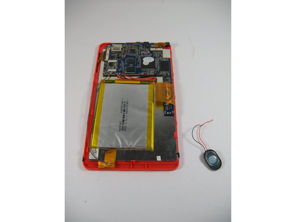

    • Use the plastic opening tools to pry the screen from the back of the device.
    • Gently flip the back over without damaging the wire connecting the speaker to the rest of the device.
  2. Hipstreet Titan Plus Speaker Replacement: crwdns2935265:02crwdnd2935265:01crwdnd2935265:01crwdne2935265:0
    • Use Spudger to remove speaker from back casing of the device.
  3. Hipstreet Titan Plus Speaker Replacement: crwdns2935265:03crwdnd2935265:01crwdnd2935265:02crwdne2935265:0 Hipstreet Titan Plus Speaker Replacement: crwdns2935265:03crwdnd2935265:02crwdnd2935265:02crwdne2935265:0
    • Use Soldering Iron to heat up the ends of wires connecting the speaker to the motherboard until they come free.
    • Remove the speaker from the device.
