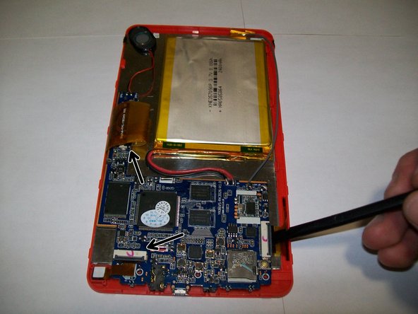

  4. Hipstreet Titan Plus Screen Replacement: crwdns2935265:04crwdnd2935265:01crwdnd2935265:02crwdne2935265:0 Hipstreet Titan Plus Screen Replacement: crwdns2935265:04crwdnd2935265:02crwdnd2935265:02crwdne2935265:0
    • Use the spudger to release the three black clips.
    • Ensure to remove the main far right clip, which connects the screen to the motherboard.
  5. Hipstreet Titan Plus Screen Replacement: crwdns2935265:05crwdnd2935265:01crwdnd2935265:02crwdne2935265:0 Hipstreet Titan Plus Screen Replacement: crwdns2935265:05crwdnd2935265:02crwdnd2935265:02crwdne2935265:0
    • Remove the three screws from the bottom of the motherboard.
  6. Hipstreet Titan Plus Screen Replacement: crwdns2935265:06crwdnd2935265:01crwdnd2935265:02crwdne2935265:0 Hipstreet Titan Plus Screen Replacement: crwdns2935265:06crwdnd2935265:02crwdnd2935265:02crwdne2935265:0

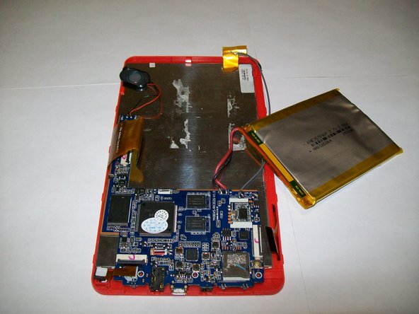

    • Use a spudger to gently remove the battery from the motherboard.
  7. Hipstreet Titan Plus Screen Replacement: crwdns2935265:07crwdnd2935265:01crwdnd2935265:01crwdne2935265:0
    • All components will be removable from the screen after the battery, motherboard and all the black clips have been undone.
  8. Hipstreet Titan Plus Screen Replacement: crwdns2935265:08crwdnd2935265:01crwdnd2935265:02crwdne2935265:0 Hipstreet Titan Plus Screen Replacement: crwdns2935265:08crwdnd2935265:02crwdnd2935265:02crwdne2935265:0

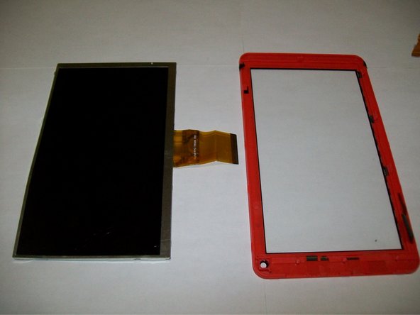

    • Use the spudger to push back the clips along the side of the device and remove the screen.
