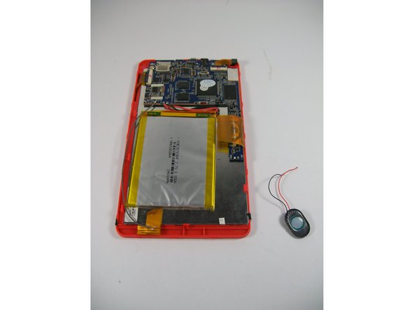

  2. Hipstreet Titan Plus Motherboard Replacement: crwdns2935265:02crwdnd2935265:01crwdnd2935265:01crwdne2935265:0
    • Use the spudger to remove the speaker from the back casing of the device.

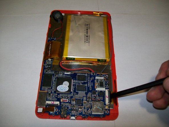

  4. Hipstreet Titan Plus Motherboard Replacement: crwdns2935265:04crwdnd2935265:01crwdnd2935265:02crwdne2935265:0 Hipstreet Titan Plus Motherboard Replacement: crwdns2935265:04crwdnd2935265:02crwdnd2935265:02crwdne2935265:0
    • Use the spudger to release three (3) black clips connecting the components to the motherboard.

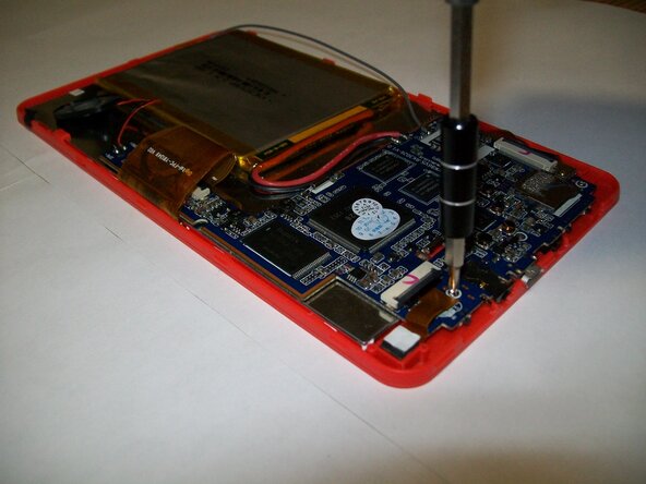

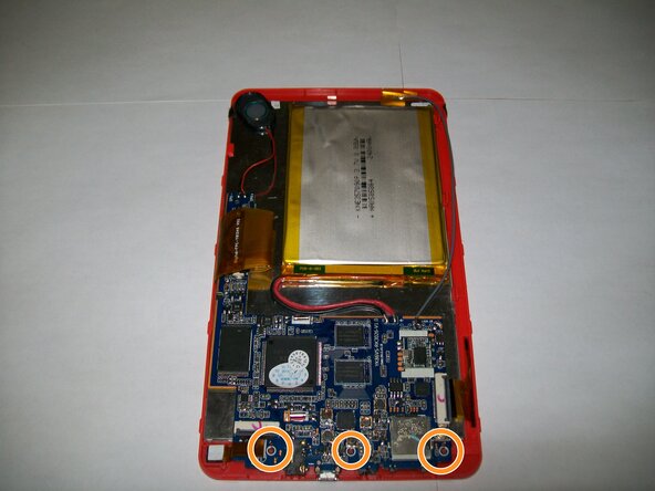

  5. Hipstreet Titan Plus Motherboard Replacement: crwdns2935265:05crwdnd2935265:01crwdnd2935265:02crwdne2935265:0 Hipstreet Titan Plus Motherboard Replacement: crwdns2935265:05crwdnd2935265:02crwdnd2935265:02crwdne2935265:0
    • Unscrew the motherboard using a J0 Phillips head screwdriver.

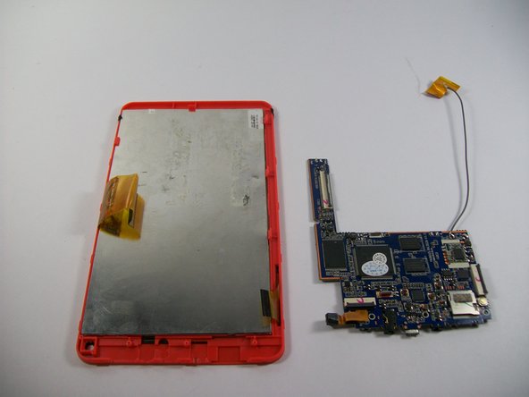

  9. Hipstreet Titan Plus Motherboard Replacement: crwdns2935265:09crwdnd2935265:01crwdnd2935265:02crwdne2935265:0 Hipstreet Titan Plus Motherboard Replacement: crwdns2935265:09crwdnd2935265:02crwdnd2935265:02crwdne2935265:0
    • Now that the battery and speaker are removed, the black clips are undone, and the motherboard is unscrewed, remove the motherboard.
